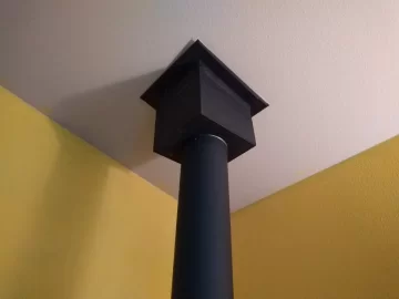

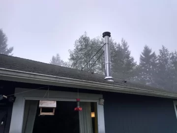

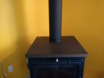

Can you describe how the stove is vented? Starting at the stove's flue collar, how does the exhaust get outside the house? Pictures of the flue inside and outside would help.

I'm still learning the nomenclature, but I think these photos give you the information you're asking about.

The top of the flue is above the ridgeline, but not by a lot. It was already installed when we purchased the home. The professional that came to install the stove said the chimney was well placed and looked good.

What is total length of pipe? Looks like at most 15ft. how does it draft? Any smoke smell?
