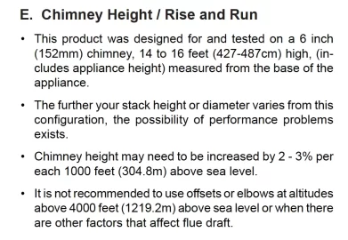

Your stove manual has a more extensive "do and don't" list for chimney location requirements than I am used to seeing, makes me wonder if the stove's draft is very sensitive. They even put minimum draft requirements
B. Draft
Draft is the pressure difference needed to vent appliances successfully. When a appliance is drafting successfully, all combustion byproducts are exiting the home through the chimney.
Considerations for successful draft include:
Recessed lighting Attic hatch Duct leaks
Preventing negative pressure Location of appliance and chimney
To minimize the effects of negative air pressure:
• Install the outside air kit with the intake facing prevailing winds during the heating season
• Ensure adequate outdoor air for all combustion appliances and exhaust equipment
• Ensure furnace and air conditioning return vents are not located in the immediate vicinity of the fireplace
• Avoid installing the fireplace near doors, walkways or small isolated spaces
• Recessed lighting should be a “sealed can” design • Attic hatches weather stripped or sealed • Attic mounted duct work and air handler joints and seams
taped or sealed • Basement installations should be avoided
To be sure that your appliance burns properly:
• During a low burn, the chimney draft (static pressure) should
be approximately -.04 inch water column (W.C.)
• During a high burn the chimney draft should be approximately -.10 inch (W.C.)
• Measure the W.C at 6 inches (152mm) above the top of the appliance after one hour of operation at each burn setting.
NOTICE: Hearth & Home Technologies assumes no responsibility for the improper performance of the appliance system caused by:
• Inadequate draft due to environmental conditions • Downdrafts • Tight sealing construction of the structure • Mechanical exhausting devices

The OP's stove manual even had a special disclaimer for improper draft - almost like they had a bunch of complaints and found the need to put in the disclaimer. In any case, 10 feet is way too short for almost any stove.
