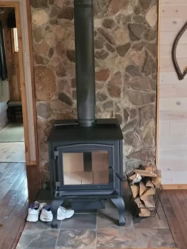

I just bought the osburn 3300 .have only had 1 little break in fire so I cannot tell you how it will perform.it is a nice looking stove.there was another person on here that just ordered one as well
  • [Hearth.com] New stove purchase (questions)
