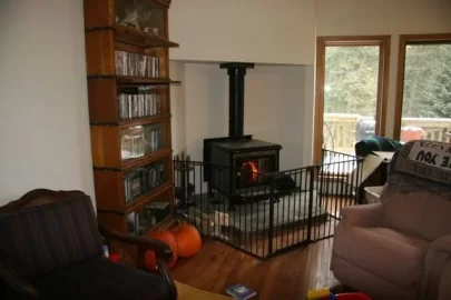

So i have had this stove for a few weeks now. Someting i notice right off the bat is i dont get the same intensity of fire as i did with the heratige. It burns much slower, and it much harder to get going. It doenst smoke in the house or anything (even with the 100 mph winds we have had the last few days) but its just sluggish to start. I think alot of that has to do with my wood. Im burning the standing dead i cut down in the late summer. Im realy regretting not gettig my wood under cover this year. We are getting tons of snow. The other day it was well over the bucket on the honda 1123 snowblower. Somhere in the nighborhood of 34 inches of snow. I have to dig my wood out every time.
Im getting much longer burn times with this stove. Its not uncommon for me to get a all day burn if i pack the wood in just right. Literaly it will burn for 10-12 hours. I think this is due to the new stove and good gaskets. Or it could be because of the "slower" draft.
Im a few inches too close to the wall. Makes me a little nervous but what can i do about it now. They want 9" from the rear, and i have 7. I do have the heatshield and the back wall is a micore like product, but still im out of the envelope of what the manufacture allows. I dont recommend you try that at home folks. I think i am going to get a couple of 45's and bump it out. I dont realy want to do that beacause of the draft being slow already.
These stoves are beautifull, i realy like the look of soapstone. I liked the fluecollar better on the heratige. I dont like the "HEARTHSTONE" stamped in the front of the flue collar on the masfield. Also the lines of the stove and the legs more suited me with the heratige.
Photos :)
