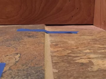

I stubbed my toe on a tile the other night so when the owner contacted my today about coming tmw to take care of a different minor detail I mentioned to him that it seem a couple tiles were out of whack.. I work odd ball hrs so I'm long gone before they get here and gone before I get back and I told him I would place tape on the tiles I was concerned with...
Well I just got done going over the floor and I found a lot more than a couple. I'm up to about 25 tiles that have what I consider an unacceptable lip along an edge. My determining factor is where or not I could slide my roll of tape across the floor with out issue. There doesnt appear to be any pattern to what ones are out of whack, like they were rushing to finish up one day or something they are all over..
I dont expect it to be perfectly level in every direction but this seems terribly unacceptable. Am I expecting too much??? Give me a few minutes and Ill get a few photos put up...

Definitely unacceptable. If the subfloor is to blame, it should have been repaired as part of the job.

I have been setting tile (and all other hard floor coverings) for 15 years, and someone with absolutely no flooring experience at all could tell you that is jacked up.
If it was natural slate, some unevenness is expected but not with a porcelain tile. Heat Seeker is right, if subfloor was wack it should have been addressed but either way not acceptable.

To answer your question: No, you're not being too picky. That tile looks like it was laid by someone who's never done it before.

Poor craftsmanship - unacceptable.

That's very poor workmanship. I'd be upset too.

If they applied tile to plywood you should have them pull the complete floor out. I spent 20 yrs. in the tile install industry and have seen this type of install fail 99.9% of the time. Find a real tile contractor.

seen many a tile guys use the old roll of painters tape! That is not a very good job, oddball one here or there happens, I think Ive got two and not even close to that severe on my whole main floor. I would not be happy! Hope they make it right for ya
That's a bummer. I'd certainly ask for it to be fixed, which is going to be an even bigger bummer for the contractor. For some things, such as tile work, you should consider hiring someone that solely works in that field. Let us know how you make out.
