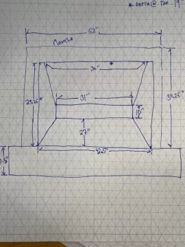

I am looking to have a fireplace insert installed, and looking for some help. I have ben lurking here for quite awhile, and I am finally getting around to getting this project done.
I have an existing wood burning fireplace that the previous owner installed a gas log set in. I am looking to put in a wood burning insert. I would like to install as large of a fireplace as possible, preferably with the style the extends out somewhat, for more heat output during power outages, heating a tea kettle, etc.
A more rustic style would fit the decor.
Not terribly concerned about price of the stove, just looking for very high quality, performance, etc.
I have attached a hand sketch of the dimensions, as well as a couple of pictures of the fireplace. I plan on removing the mantle, and installing a more simplified version of a shelf across the top. You can see the edge of the vents that they covered with the mantle down where it meets the hearth.
The house is a 3500 sq ft ranch. The room the fireplace in is fairly large, an A frame section of the house. At least 15 feet tall. The fireplace will be used as supplemental heating to the house, but I would like it as large as possible without getting ridiculous, for whatever that means.....
I am sure there are items I have missed... I can try to fill any glaring holes, and can get better pictures when I am back home later today.
