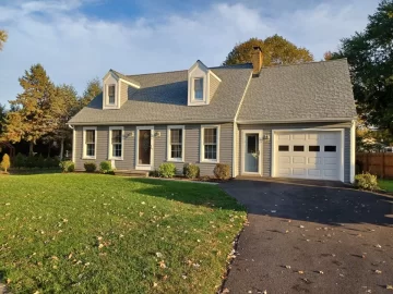

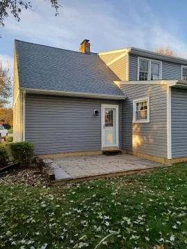

My Chimney is About23 or 25 ft only the top 4 ft is sticking outside The rest is going up inside my garage and junk room over the garage it's a traditional flue block with The flu liners and a Single wall s.steel liner inside of that no damper, But when the stove is cruising at 500 to 600 deg the flu gauge is only reading around 300 or so

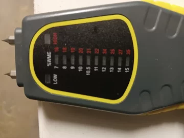

Just Got a Moisture Meter its 8 to10 percent on the oak, and 16 to 17% for the ash.

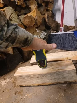

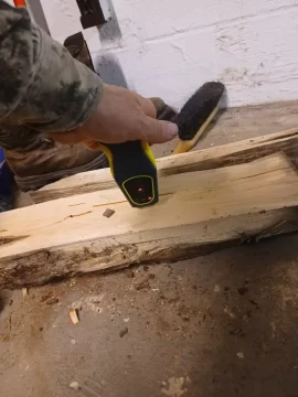

Did you resplit a piece and measure it on the freshly exposed (and room temperature) surface? Parallel to the grain?
8-10 pct on oak is near impo imo...

Yes I Split a Piece of oak and ash At room temp in basement ,Now I did make one Misteak The oak Is Now 4 yrs old I Know Because I Cut It It's Looking Pretty Gray and Yes 8 to 10 % Is what my Digital Meter is Yelling Me, When I Get Home I'll Send You A Picture Of the Ash and Oak Readings, So I Know I've got Dry Wood
stoveliker
Nov 17, 2019
7,261
Long Island NY
Fair enough. Lucky you; <10% oak has to be fantastic.
We can safely rule out the wood.

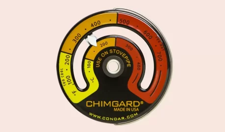

Is this surface temp on single-wall stovepipe or with a probe thermometer on double-wall stovepipe?
Reactions: clancey

If the reading of 300ºF is on single-wall stove pipe with a magnetic surface thermometer, then that is a normal burn temp. Inside the stove pipe the flue gases are 1.5 to 2x hotter.
