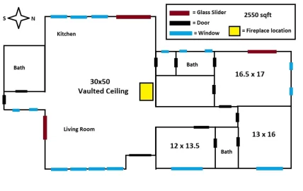

I moves from southern Ca to whatcom county, Wa. polar opposite climate for the most part. We are looking to put a wood stove in our house to serve as primary or supplemental heat and as a backup heat and cook source for when power is out as we are all electric now.
It doesn't get too cold up here (winter avg 25-45*) and we normally have our thermostat set at 66-68* so we don't need it to be roasting hot. However with the crawlspace, all the windows and likely the lack of house being airtight (we feel drafts but haven't pinned down from where yet) the heater seems to cycle quite often.
We love the look of the Cape cod, ashford 30, and the like. However as stated our primary concern is heating ability and cooking ability for power outage situations. I'm gone from home often so a long burn time would be nice for the wife to not have to keep tending it. I'm not thrilled to pay over 3k for a stove but am not opposed to it.
I'm sure i have forgot a few things but I have 4 kids so I must tend to them now.
I made a sketch of out house layout. It is a single story, crawlspace, vaulted ceilings in living room/kitchen (11ft at peak), wide 4ft hallway and 36" doors. 2x6 construction build in 2005, double pane windows. But it feels much colder than it should be so I will be pulling trim this summer to check window gaps.
