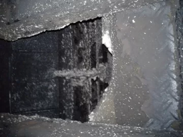

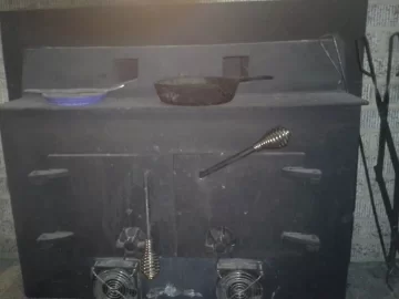

Here is a couple of pics hope they help.. The first pic is self explanitory. Second one is from the bottom of the insert looking up to the damper .(yes there is a handle)

Ugh. That is an old tank. Replace it if you want to save some wood and burn cleaner. Regardless have the chimney completely cleaned first, then line it.
Do I see correctly that you can look right through that rectangle opening into the chimney?? There is not even a stovepipe up into the damper area? I could not have a fire in that stove and sleep well at night. I would frankly not even run it at all.
I agree with BeGreen: Get a modern insert with a full liner and a block-off plate = Save on wood, get more heat and burn safely.
