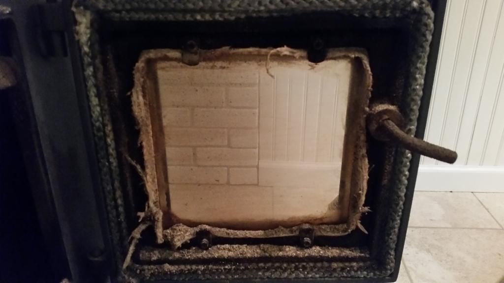

I got home after work on Friday and cleaned it out because it looked like this:
[Hearth.com] New to having a pellet stove

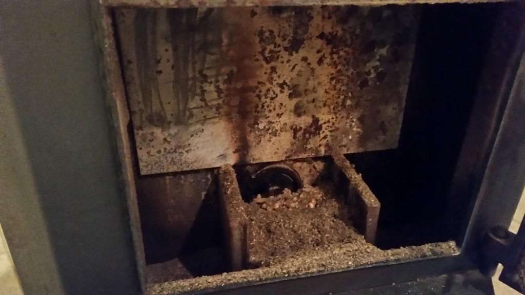

and this:
I didn't take any pics after I had finished, but I'm thinking I'll need to replace the inner rope door gasket soon.

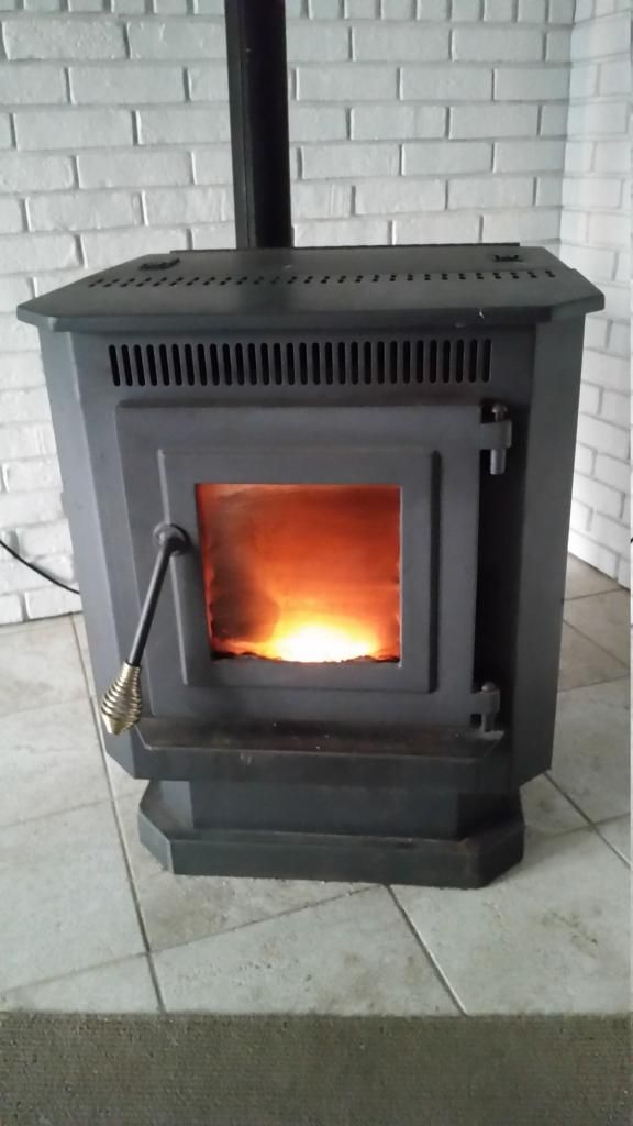

I then proceed to RTFM and then fired it up for the first time. Only problem with that was that I did not realize at first that while my stove is a 55-SHP10, it was built before 2004 and does NOT have auto-start. So I wasted a few minutes waiting and staring at un-burned pellets before I realized this. Oops! Once I figured that out, I added some starter gell the previous owners left, lit it up, closed the door, and turned it on. Results = FIRE!! :)
I kept the feed setting and fan low just so I can see how the thing runs. So far, so good. Will wait until it gets cold again (Thanksgiving) and will fire it back up and crank it up a bit to see how much of a difference changing those settings make. Wish me luck!

Also, as you can see from the picture the gasket on the glass is falling apart. Is that something that should be taken care of sooner rather than later?
The gasket around the window wouldn't concern me too much. The one around the door is more important. An easy way to check the window gasket would be to use an extinguished match right after you start the stove up (before the room blower comes on). If you see any of the smoke from the match drawn into areas around the window, then you may want to consider it.
You can check the door gasket by pinching a dollar bill between the door and the flange. If it can be pulled out with a gentle tug (repeat several times around the door), then the door gasket needs to be replaced.
My window gasket looks similar, but is holding fine. I just take a pair of scissors to the loose pieces every now and again to clean them up.

Compared to my stove. I don't see the retaining taps for the impingement plate. Is it a shadow or has it been burning with it upside down.

I do not believe that there any tabs on my impingement plate...I noticed that was different when compared to the clean-out video I watched on YoutTube. It could be that they changed the design on the 2004 and up models??
It's an older stove, so I don't know what the configuration of the tabs are on his version. To the OP, make sure that the bottom of the impingement plate is up against the back wall of the stove. On the newer stoves, there are two tabs just above the insert that hold it in place. Your's may not have them..
