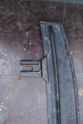

    I might try to see if I can get a welder to braise/repair the ash lip as the tabs broke off cleanly and it's a non load bearing piece that shouldn't get too hot during use, so there's a good chance the repair would hold just fine. The "good" dealer is going to check and see IF they will sell me the 3rd burn tube by itself, if they won't, or it's an extremely high price, I think I'll just make one.

    I know that welding/brazing cast iron can be tricky, especially if it's to the stove body that gets very hot and also expands and contracts. But with the ash lip from my IR, I'm thinking that maybe it could be repaired? It's $110 for a new one (and maybe another $15 in shipping) so if it's possible to fix this one it sure would be nice......
    So, those of you who've had experience with repairing cast iron, do you think this is repairable?
    Thanks!
    NP

    It's certainly worth a try. Take it to a shop that does this regularly. Maybe one that repairs automotive headers. If the price it too high to fix, then as a last resort I would try JB Weld epoxy and a reinforcement strap before scrapping it.
    http://www.muggyweld.com/castiron.html

    Yes, I would say it's repairable. I had the cast iron gearbox on our hay rake bind and break the whole corner of the bearing carriage out and to make a long story short I brazed it all back together built it up with more braze material and then ground it back down with a die grinder to the original dimensions and six years later when we sold it it was still functioning fine. That was a part that had stress on it so that ash lip should not have a problem at all.

    Yeah, I was thinking about JB Weld too, I've fixed a fair amount of stuff with it that held up for an amazingly long time......Given that the ash lip won't be exposed to super high temps and it's not really taking any load/weight, it might repair pretty well. I also thought about drilling it and putting pins in it......any thoughts on that?

    You can tell better than I with the pieces at hand. And you can see how the tabs mate to the main body of the stove. I like the idea of reinforcing an epoxy joint to strengthen it mechanically if you choose that route. Pinning could be tricky for exact alignment but it would work. Or perhaps screwing a stiffening plate on the bottom that connects both pieces is possible? Get it mechanically as solid as possible, then separate and glue. Rejoin and screw while the glue is fresh and rescrew. Still, I'd speak to a good welding shop first to see what they think and to see if they are set up for this type of weld.

    BeGreen probably has the best idea I would definitely try drilling the two pieces and adding some round stock steel to act as a dowel rod between the two pieces.
