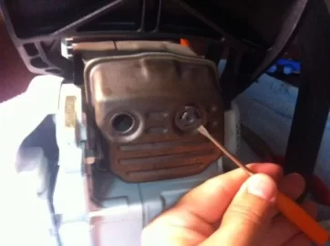

Again, this is the carbureted version of the MS261, not the Mtronic version. Computers always seem to cause more trouble than they're worth after a couple of years and I didn't want something else to go wrong. I may be wrong, but I may be right. Either way I'm happy I think!
First I wanted to check to see if the spark arrester screen was plugged up. I didn't know it was in a screwed in spot on the side, so I took off the two visible bolts on the muffler.
