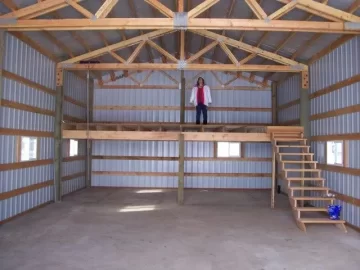

The stove will(eventually) go in the lower part, under the loft...
  • [Hearth.com] New to me stove for the shop
Is the office on the upper level or lower level? If upper, pop the pipe right up thru the roof. You got such a great deal so far, spending to money on a pro to install it makes sense. Just dont call a chimney sweep out of the swap sheets, go to a Hearth Shop and only use an NFI Certified Technician if possible.
The office will be under the loft. I had foam insulation put under the slab when built.
With the pipe I bought, I could go straight up, or out the side and up...
The pipe is galvanized.
Outside with a cleanout T would be good, no ladder climbing every year.
Inside chimney protects the pipe better, but harder to clean....
What to do?
