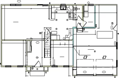

Hi all. I am considering a Harman XXV as I really like the look of the stove and reviews seem really positive. However, I would like to know if this size stove would be sufficient considering the following floor plan...I am going to place to stove at the upper left wall on first floor as detailed below (left wall of family room/breakfast room/kitchen great room), either centered on wall (below tv) or in the upper corner. Are these good locations?.
First floor:

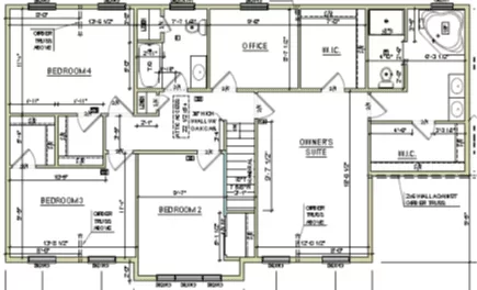

Second floor:
[Hearth.com] New to pellet stoves, question about needs/size
I currently heat the home with an electric heat pump, typically at a thermostat setting of 68 in the winter. Wife complains as the heat pump doesn't really put out a "warm" air and she constantly "feels" cold. I can't complain as to the cost of running the heat pump, as in WV electricity is relatively inexpensive. Sadly, I will probably never be able to recoup the cost of the pellet stove and install (approximately $4500 from what I understand) along with the cost of pellets (maybe 1-2 tons a year?) in comparison to the electric heat pump. However, the "warmth" the pellet stove will provide will be worth the added cost. As well as the comfort in knowing I can heat my house in the advent of a power outage (which occur at least annually for extended days).
Just wanted to hear opinions from the collective knowledge base here prior to going to the local installer for their opinion. Given the floor plans, would the stove heat the primary floor well? would the heat travel up to help heat the 2nd story? House is situated on a 9 foot solid pour concrete basement. I do not plan on heating the basement over what the heat pump now provides. House built in 2008 and relatively good construction, well insulated. Current electricity usage is around 15k kilowatt hours for the whole year, all inclusive. House is 2750 square feet plus 1250 square foot basement.
Thanks so much if you made it through this long post. I appreciate any insight as I am completely new to pellet stoves and would love to make the right choices!
The xxv would in my opinion help heat your home but not entirely by itself. It's rated for 900 to 2300 square feet.your first floor would be pretty warm but up and down stairs would be cooler

honestly if you are going for suplemental warmth only, dont worry about uppting to a bigger stove. the XXV will heat your main floor well. no stove is going to keep your upstairs warm with your house layout. also you will be keeping your heat pump on normally right? so you are really just looking for 10-15k of suplemental heat in the room you use the most. Go with a smaller stove that you like and fits your other needs (astetics from the sounds of it) the XXV sounds perfect for what you are looking for. maybe bigger than you need really. also keep in mind that pellet stoves require electricity. if you are looking for backup heat in an outage maybe you would consider a wood stove or a gas insert considering you are not looking to go through a lot of fuel based on your needs.

based on the layout i

and yes, i agree with your locations. that corner install particularly looks like it would blow straight to your stairwell. remember that pellet stoves are convection not radient, and they convect straight forward.

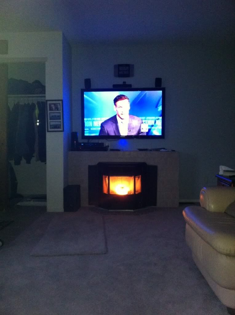

Just as a reference. ...
(broken image removed)
Had this one in an unfinished basment...cranking in the winter. I had a heat pump, but felt like the AC was on in the winter time. I did have NG as backup on my heat pump. For when it got less then 25 outside.
