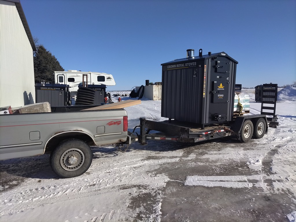

Brought it home last February to get it before a price increase knowing it'd get installed over summer.
[Hearth.com] New to the Forum - Crown Royal 7400MP

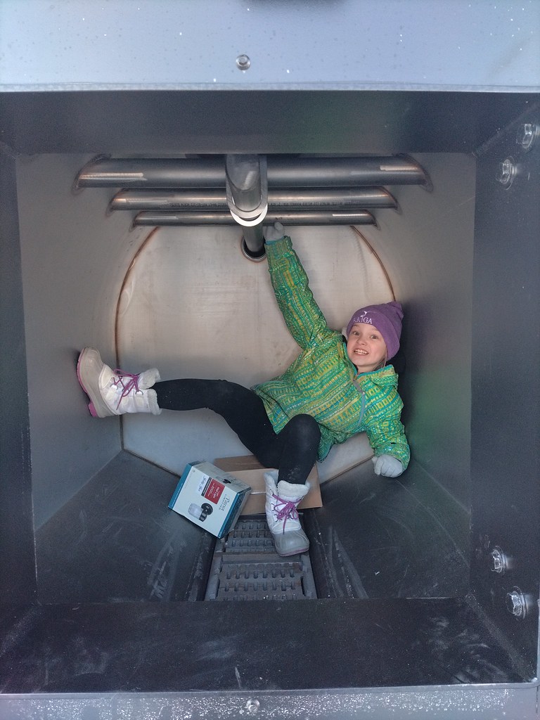

Miss Lily and her 9yr old self looks pretty small inside the firebox lol

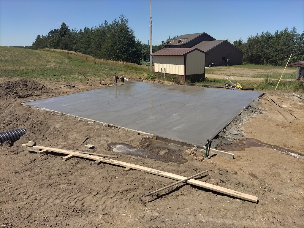

It was decided to put the stove right here so it's in the middle of the house and shop. Only issue is there is a ditch that runs through here that drains a couple acres .....

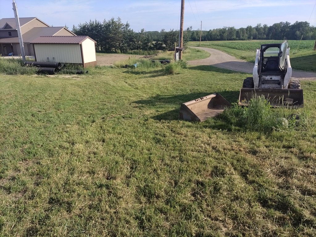

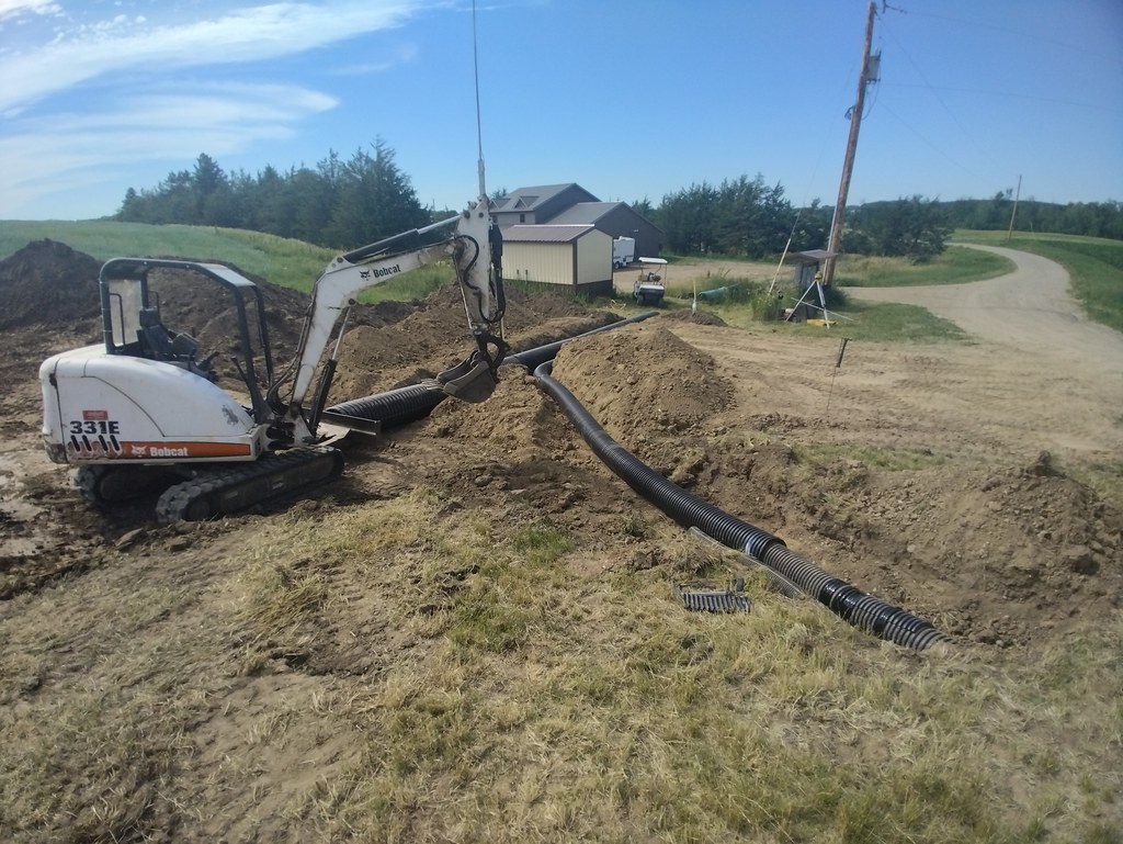

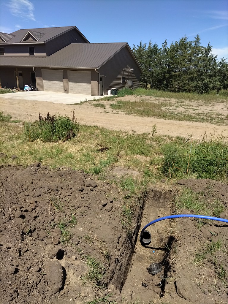

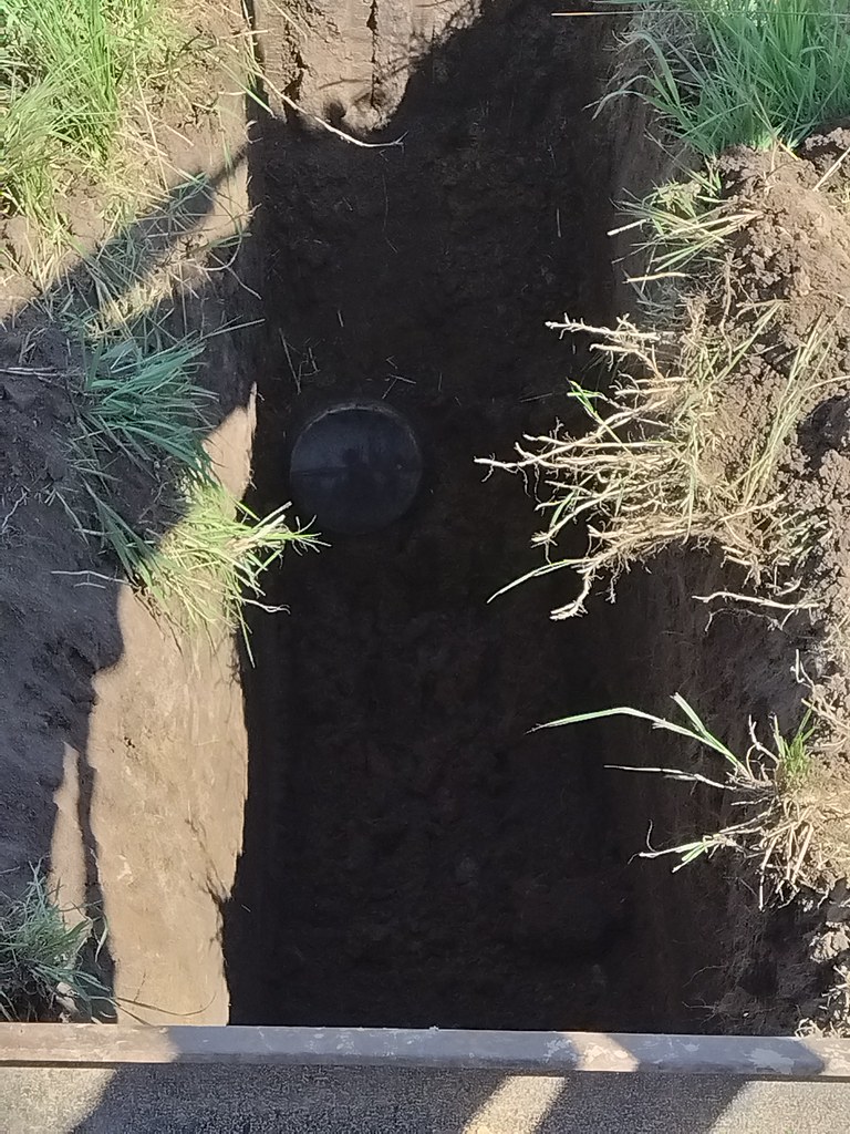

Move some dirt ... extend a drain line .... install a new 18" Dual Wall pipe to drain surface water ....

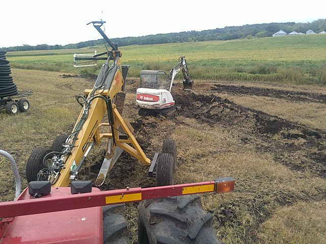

Everyone I talked to that had a stove grumbled about dealing with dirt and mud so we decided to spend the $$$$ and pour a 24x24 pad. Hopefully one day we can build a building over it to keep the snow and rain off the pile ....
When we built the house I buried an 8" piece of drain tile from this point up into the mechanical room so we could bring the line up into the house without going surface mount through the garage at all. This worked very well but was a bugger to get the boiler pipe through it. I ended up using a 5gal pail of wire lube to get it to slide nicely. One I dumped that into the 8" line it almost pulled itself in lol. The blue water line now houses a fiber optic line that goes from the house to the dmark in the well house to bring internet into the house.

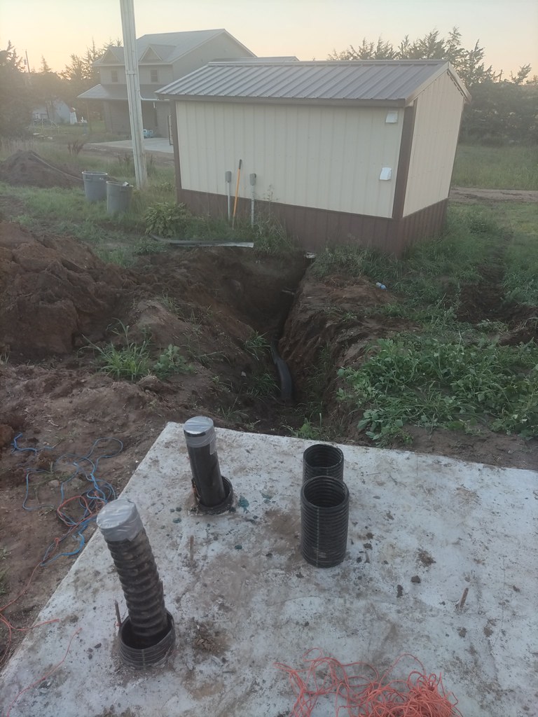

Three yrs ago when we built the farm shop I did the same thing and buried an 8" sleeve up into the mechanical room. I figured it was cheap insurance and a few others on here have posted saying they wish they would/could have done it so I figured why not. Sure glad I did !!

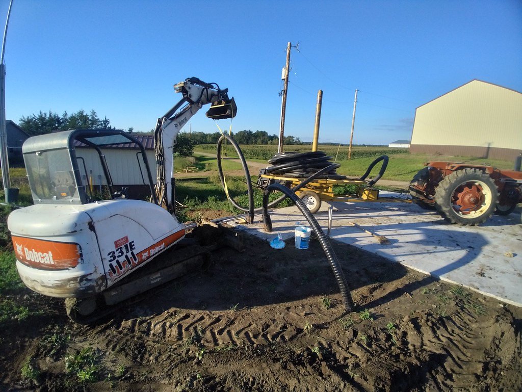

I purchased a GIANT Chinese finger trap deal meant for wire pulling and it made the install soooooo nice !!! If anyone wants it let me know. I doubt I'll ever use it again.
I used the MiniHoe as a guide of sorts to keep the pipe moving smoothly. Worked well but needed another guy constantly shoving the pipe through the strap.

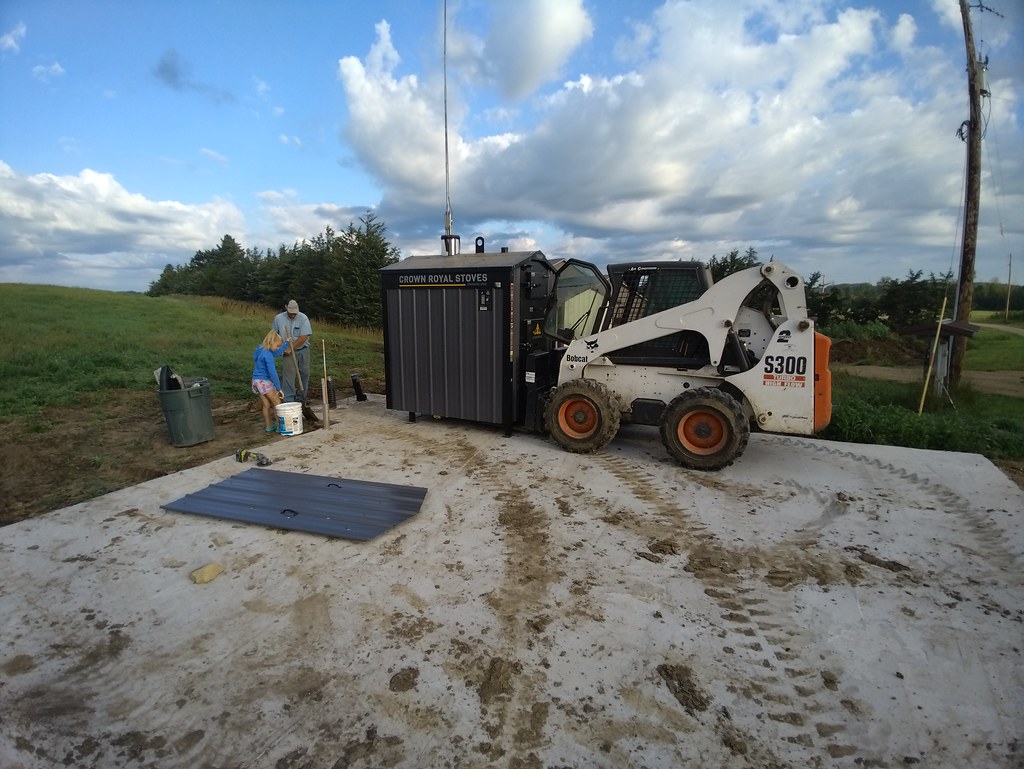

Time to set it in place !! This was a looooong time in coming and I was stoked when it was finally sitting in it's home.

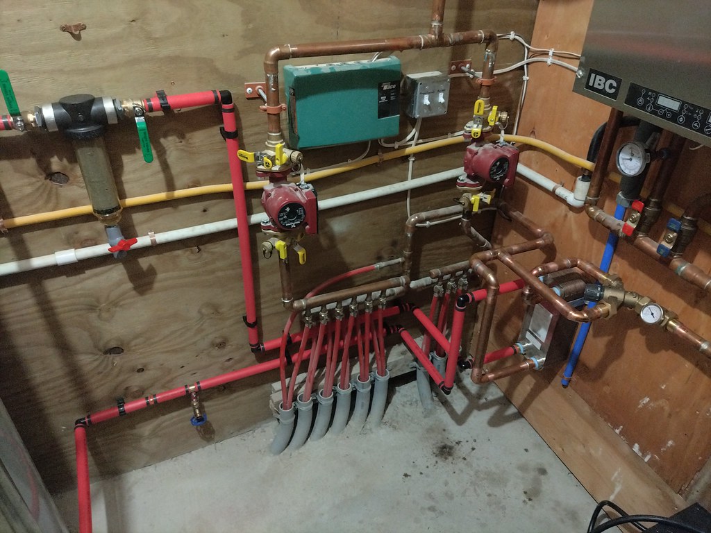

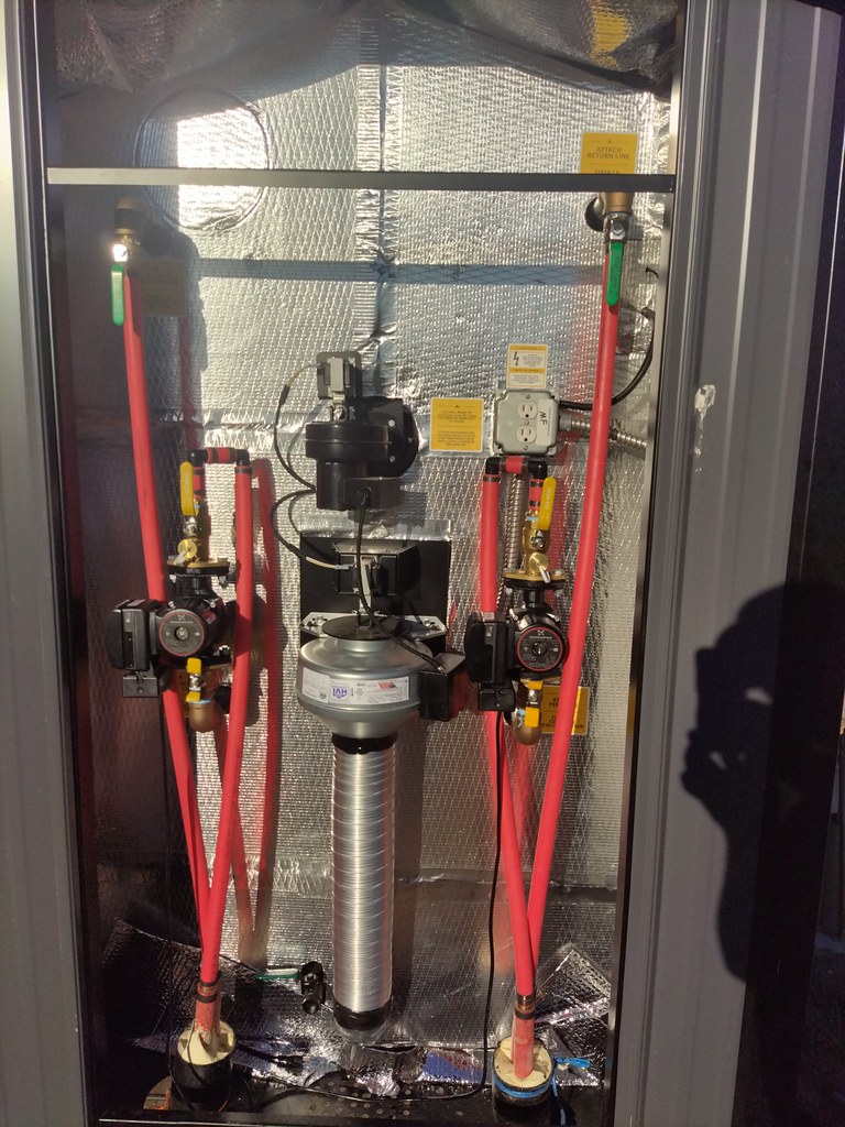

ECM Pumps and piping installed in the back of the boiler. It's all been wrapped with pipe insulation now. That alone added about 1F to the return temps. Crazy.

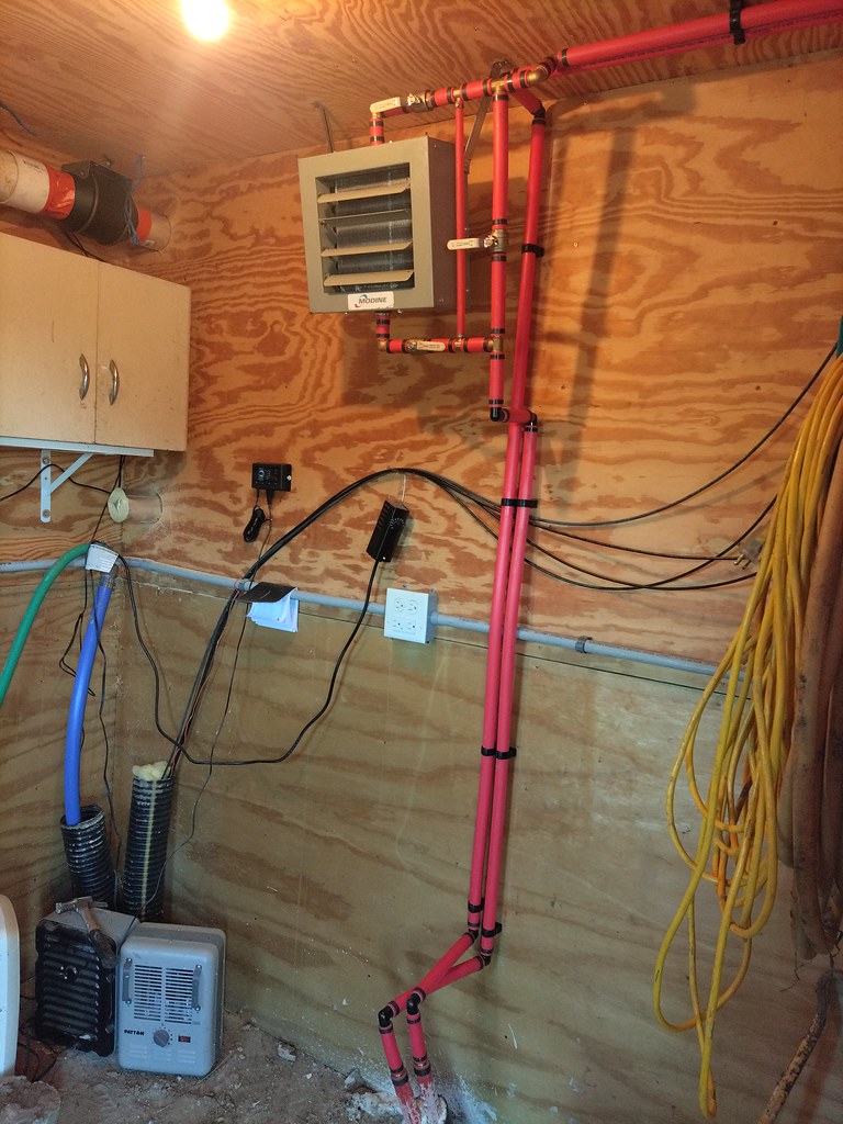

Tied it into the LP setup that was installed in the shop when it was built.
[/url]
The other loop comes into the well house and goes to the house first. The return line runs though the heater in here. This has all been pipe insulated as well ....

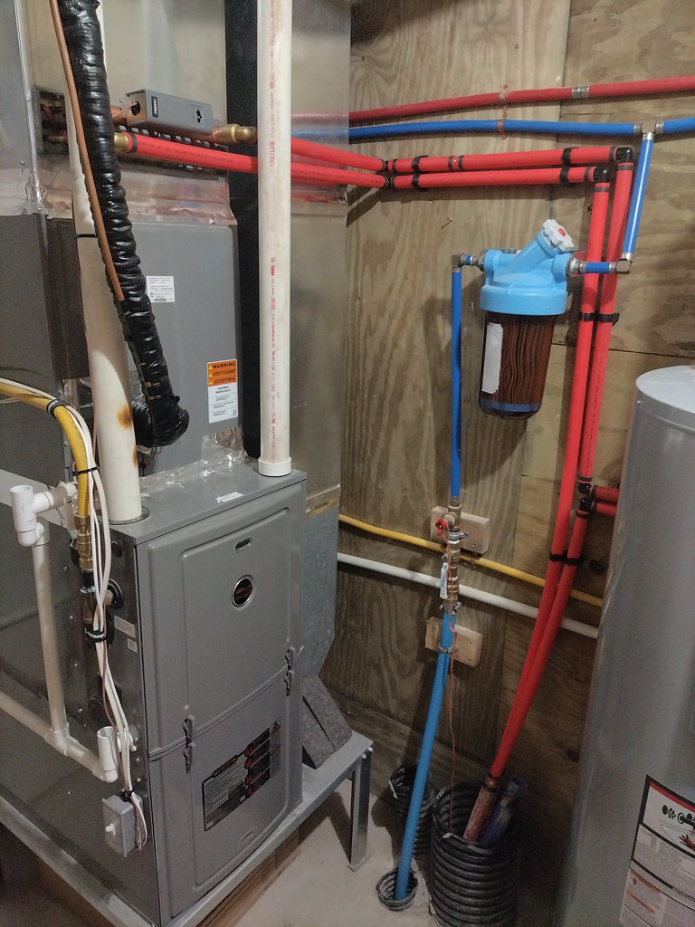

Up into the house !!!

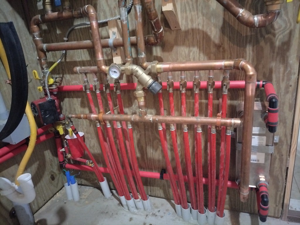

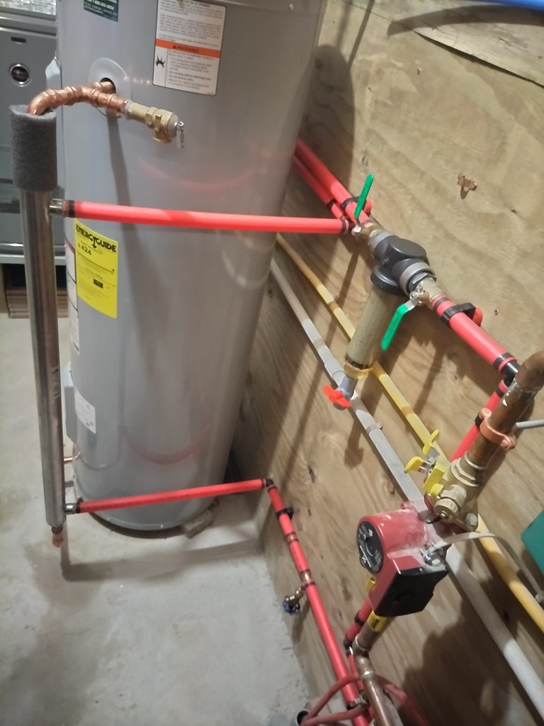

Over to the water heater side arm. I debated on doing a small plate exchanger here but we have pretty crappy well water so I wanted something that was easy to clean on the fly. I added a hose nipple on the blow off valve and there is a faucet down below that I can blow it all mostly backwards. Hindsight said I should have put a few more valves in here so I can isolate the side arm from the rest of the water heater to get it really clean. Maybe over summer when I shut it all down I can monkey with it. So far I haven't had to flush it out yet so we shall see how clean it stays.
On over to the tie into the LP system a few pictures up. I put an Aquastat on the line going to the forced air furnace so I can set it to use LP if the temp drops below a certain point just by intercepting the signal from the thermostat. Simple and it works great !! That is an idea I got from someone on here so thank you if it was you !!

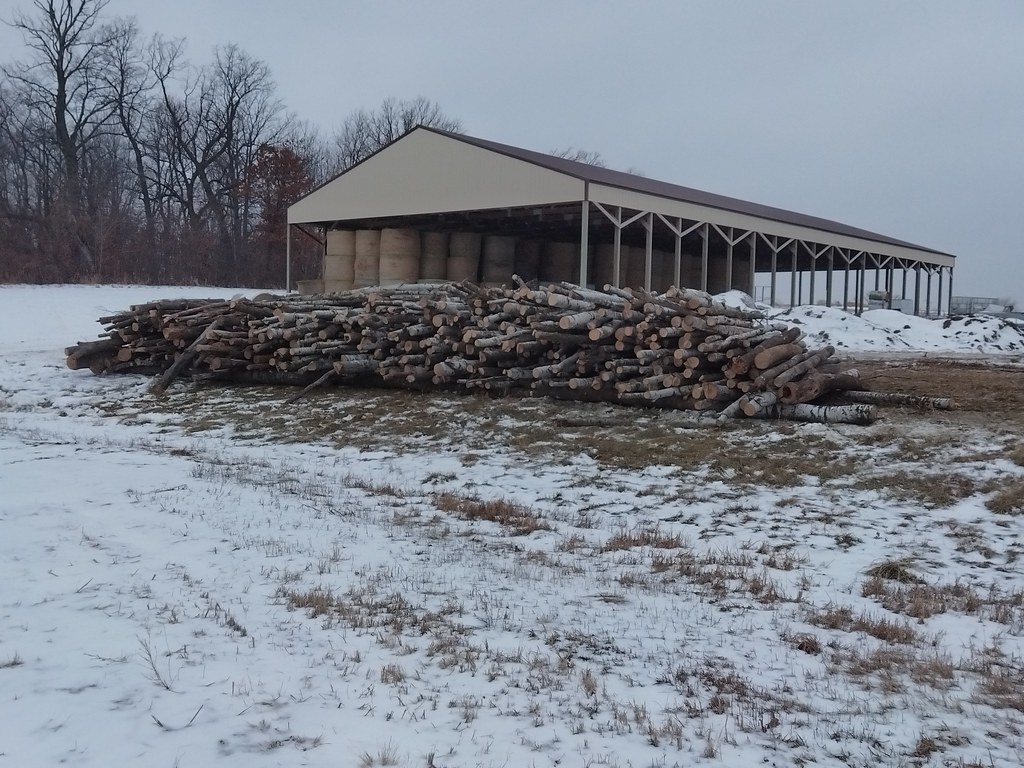

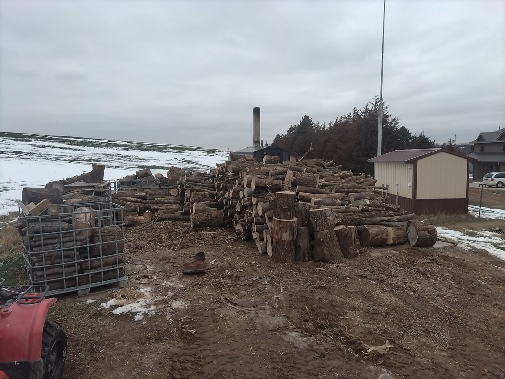

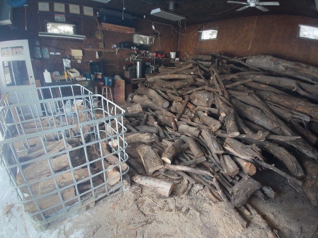

Now we gather wood like beavers .... I decided to use my old farm shop as a wood shed.
Not sure how much wood is in here but it'll be nice and dry once it starts snowing ....

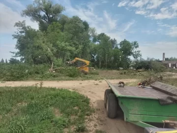

Hauling boxelder from a ditch we cleaned out and buried with a 24" pipe so we could farm over it. That's gonna be nice !! I think we hauled 18 or 19 like this home already with at least 6-7 more out there to bring home.

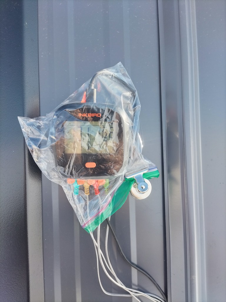

After some searching online for a temp monitoring solution I once again ran into this site with a tip to use an InkBird BBQ temp monitor. It has four probes, WiFi and is really accurate. I can see reports and graphs PLUS get alerts when the temp goes out of a range I've set. All for $100. Not bad in my book !!!

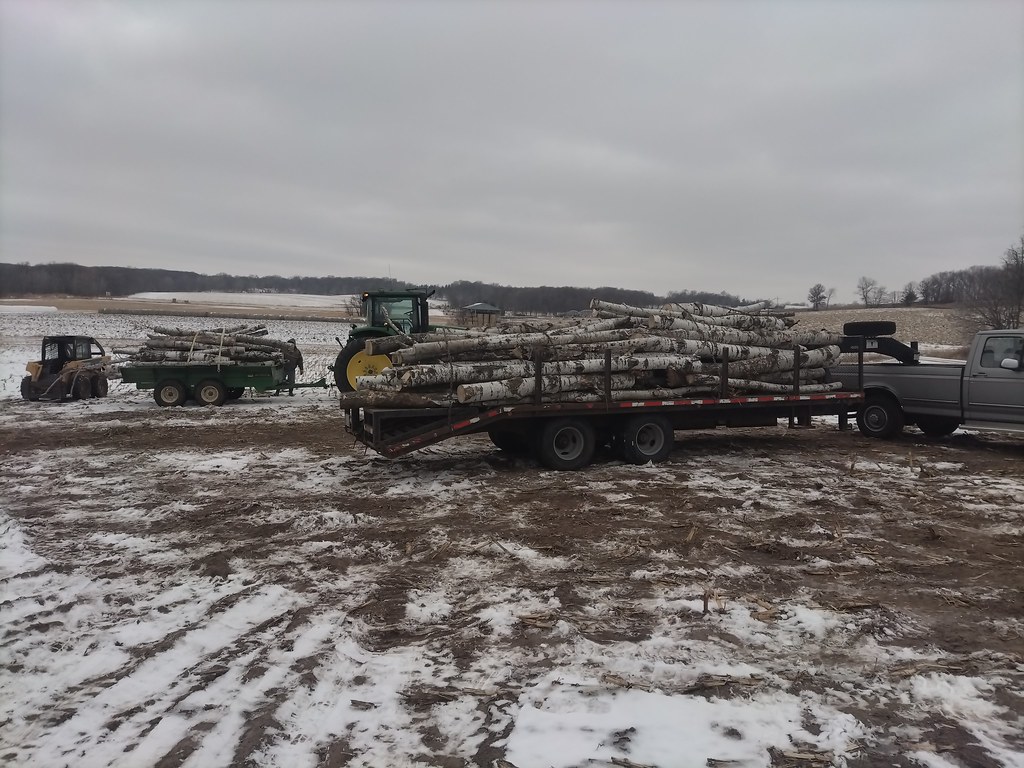

Two big loads cut up and hauled home today. Also have been spending some time blocking the poplar and other stuff I hauled home last fall. I'm going to try my damndest to fill the boiler pad up this summer !!

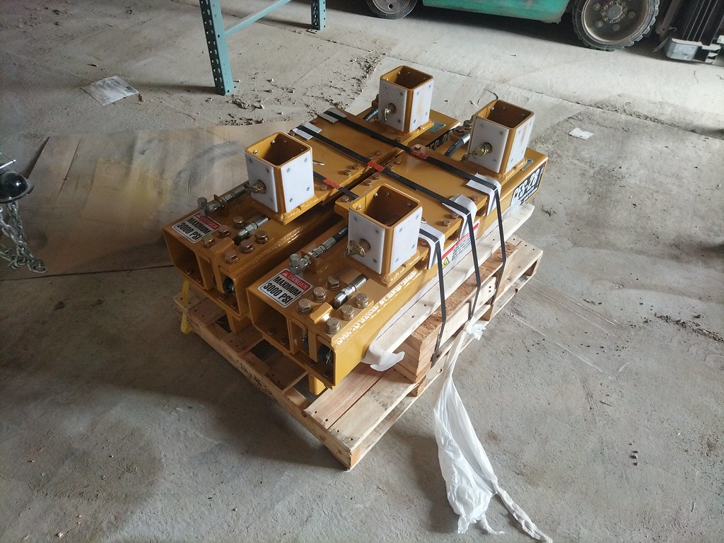

I ordered a wood splitter from Brigg Innovation a few months back and they got it built and it arrived yesterday !! There are two of them here, one for me and one for a buddy. I need to build a bracket for it that'll match up with my excavator. The white posts will get metal tubing sleeves that will be welded to a skid steer quick attach plate so I can use it on a skiddy or a mini-ex. I'm super stoked to put this thing to use !!!

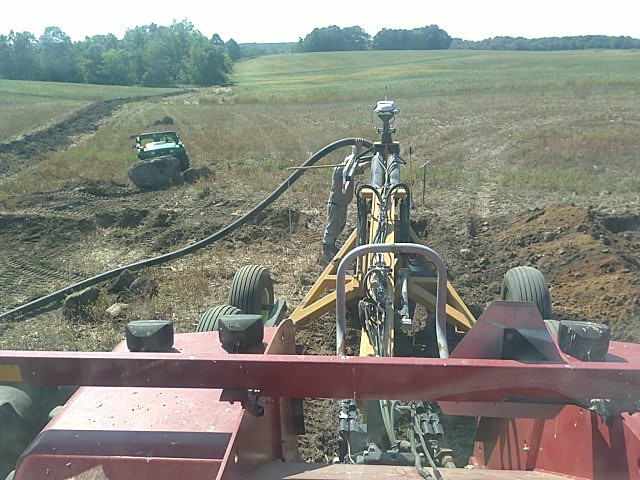

@jblnut do run a plow or trencher? Dad and I used to tile, he still does some odd small jobs, we started years ago with pt12 vermeer, built one with mods basically the same as it, then bought a 300 super D buckeye, then a JEtco RT600, the a Hydramax 2800, would love to chat sometime, will pm my number
We run a Soilmax Golddigger Stealth ZD and love it !! Full RTK GPS setup so it's super easy to run and very accurate. In our area we have a terrible amount of rocks so I don't know how a trencher would preform. All the larger commercial companies run Wolf or Interdrain with Bron plows. Those things are sweet lol
When I get back home I'll toss some pictures up of us tiling. It's a riot of a good time !!

@jblnut I see that you have a filter on your setup. I possibly have the same filter ( Ranco ) on my system. What kinds of "goodies" did you catch after you turned your pumps on for the first time ? Cheap insurance IMHO. I've read of a few instances on Facebook where peoples circulator give up the ghost and then clog their plate, or heat exchanger.

Yes it's a Ranco and yes it caught some nasty crap lol. I was going to put one in the shop before the plate exchange as well as an added protection to keep it happy.

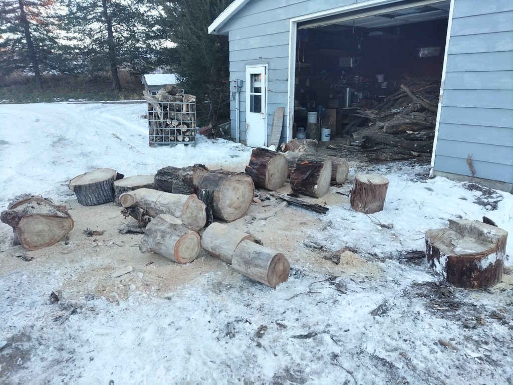

I spread out my splitter pile and started sawing them up. Our old house used to be back there and a moving company took it a few months back. I can't leave an empty space empty for long so in go wood and "misc"

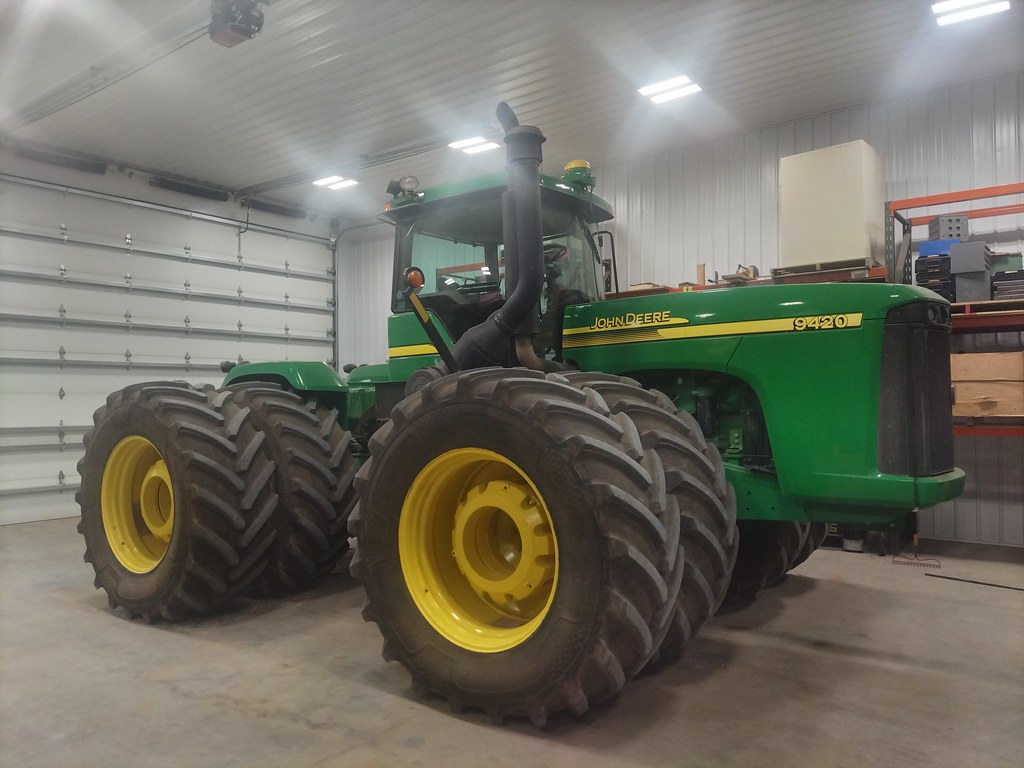

This is my latest purchase. '03 9430 with 3200hrs when purchased this spring.
