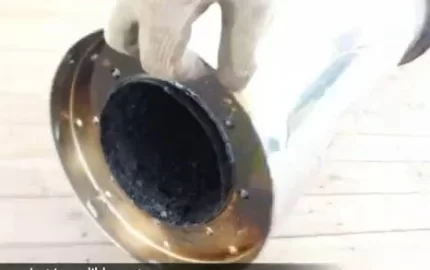

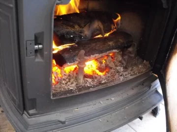

We purchased a Harmon Oakwood several years ago and from the get-go we have been experiencing whuffing problems. We actually did not know what was happening until it got really bad, as in, explosions that literally lifted the cast iron plate of of the stove top. I have document several youtube videos and I'll post the links here. I've had the manufacturer involved, the local dealer involved and several solutions offered, including a spinner cap to improve draft.

Mar 03 2012 (0:16 shows a good example of whuffing, then watch again at 0:53)

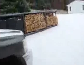

That's the only way we can burn without whuffing. Problem is the stove "eats" the wood (as would be expected). I'm currently burning white/yellow birch and maple that's been seasoned for 2 years still outdoors in a covered lean-to. One of the videos shows those.

A cap that plugged will cause this but if this happened from day 1, then draft and or low burn temps caused the plugged cap.

I'll agree the standard rain cap became plugged from poor draft. The spin cap, I believe, has solved the updraft issue.

Have you checked the moisture content of the wood? Was it packed in the shed when it was green?
No I have got checked with a digital meter. But its dry. The wood was not packed in a shed. Stored in lean-to's outdoors and covered, but yes, wood was green when put there. Initially when covered, the sun acts like a kiln in the spring and summer, you can watch the steam coming out. Very effective at drying the wood.

I don't have a digital meter with numerical readout. I do have a dig meter with a red/green digital scale but I don't rely on it as it does not seem to be very accurate. I simply go by the checking on the ends and the sound of the wood when knocked. I also resaw small planks of some of the birch and maple for woodworking small projects. Wood appears dry to me.

I do what everyone else round here does. Cut the trees down, chunk and split, then store covered from the rain and snow for at least a year. Then its indoors for a couple weeks before it gets burned. If there's something I'm not doing right, I sure wish someone would tell me.
After enjoying this forum for several years now, I can tell you one common link amongst most users having "burning issues" with their stove - the lack of dry fuel. We have had people swear on a bible, cuss at the moon and be willing to bet their house on dry wood...only to find out that it is not.
It depends on the wood species. Some are ok after a year of seasoning, some are not. If this is oak, then it takes at least a couple years to season. To test the wood moisture it has to be on a freshly split, inside surface of the wood. Resplit the wood and press the meter probes into the freshly exposed face of the wood. If you lack a meter, press it up against your cheek. It will feel cool and damp if not fully seasoned.

Stove still whuffs. Now what?

Today I can only keep it steady burning with the damper closed and draft wide open. Outside is sustained breeze of 12-15 mph all day today. Can't keep wood in the stove it burns so quick. If I try to close the draft slowly, like from wide open to half way over the course of 15 mins, the stove cools down to about 350F. If the wind stops, within a few minutes the stove will start to smoke little bits from the draft slider area...and then poof.
