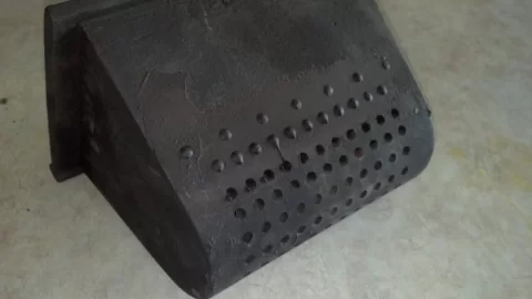

You want to use the Cast iron pot with holes at mainly the bottom.
You don't need tape for that Pot. You may still need to close a row of holes on that pot too. But you will want to use 2,000° furnace cement (sold in tubes at almost all hardware stores).
Also, take some aluminum foil and cover the qir wash on the sides (leave about 50% in the middle open, cover 25% of each side).
Do a search up top for numerous threads that talk on the Baby and its airflow issues.
Here is a pic of the pellet pot and also note the furnace cement in the 2 rows of holes. Do this to the front and back 2 top rows.
![[Hearth.com] New to the Pellet Stove World [Hearth.com] New to the Pellet Stove World](https://www.hearth.com/talk/data/attachments/96/96114-8ceab9db58acc067967ae7eff4557da9.jpg?hash=KjzN7QlBGd)

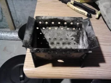

![[Hearth.com] New to the Pellet Stove World [Hearth.com] New to the Pellet Stove World](https://www.hearth.com/talk/data/attachments/96/96123-c16ab720a6709bd87ac4f7c09331c2b8.jpg?hash=8DwBu5J0In)
The pellets shouldn't be coming up over that 3rd row (from bottom), yours is up to the 5th row and higher. Thats a clear indicator that you dont have enough air.
