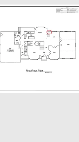

My house is about 3500 square feet. I attached a picture of a blue print of the first floor and circled in red where I hope to put the stove. The total square footage of the downstairs is about 1800 sq feet.
One of my major concerns is over heating of the space where the stove is located. With the stove being located between the kitchen and a playroom where we spend a lot of time. Which model stove would you guys recommend the Progress or Fireview?

The best way to put a stove is in the middle of the space. Also, outside the house pipe sends much of your heat to the outside atmosphere. Best to have the pipe inside with the wood stove in the middle of the house, and to have only the top of the pipe through the roof.
Draft should not be an issue with that tall a chimney, but there may be some smoke spillage when opening the stove door in milder weather until the chimney warms up. The flue system will need more frequent cleaning due to cooler cat stove exhaust and the full exterior exposure. Going up at least a few feet indoors with double-wall stove pipe will help a bit.
The Fireview can vent vertically. It shouldn't overheat the space, especially if you create a convection loop through the front entry space.

How tall are your ceilings? That looks like a pretty open space I don't think a progress would get it too hot.
My progress is in a ~400sq ft room with mostly open spaces to the stairs and kitchen totaling 1000sq ft on the first floor. I also only have 8ft ceilings which keeps the warm air lower. I can get the stove room too hot if i keep the fire really stoked but its not that hard to crack a door. My house is moderately leaky but well insulated and it rarely gets colder than the high 20's here.
You shouldn't have any draft issues assuming appropriate make up air.
The fireview is problematic for a non-fireplace install. Huge rear clearance requirements. It’s also a pretty dinky stove. Even the ph is only 2.8 cubic feet.
I would not waste time on a fireview and jump right to a ph or is. Whichever looks best to you. The IS is a better performer.
