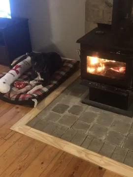

Im new to burning wood and I have a wood stove in are living room . Im not comfortable with how hot it should get it seems to get around 600 650 and still going , I have a damper and a air control on top . I was wondering how you control your fire or if anyone has tips for a newbi thanks

The most common solution is to burn thicker splits with minimal air gaps between the wood pieces. Also, try turning down the air much sooner. Not to the point of completely suppressing all flame, but to the point of making the flames lazy, then wait for the fire to regain strength and turn down the air again until the flames get lazy.

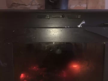

warmock Hersey model jasper model number 001545 , I try to slow it down but almost seems like it’s just doing what it wants and keeps rising.

That's an early Drolet Jasper. I don't know much about it. Does it have secondary combustion tubes above the baffle?
