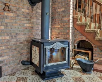

I recently bought a home which uses a wood stove as a main heat source. It has an old 30 year old custom Napoleon wood stove in it right now. The home seller agreed to buy a new chimney liner and have the stove WETT certified. See pic of wood stove below:

Jotul makes a great product. For the most part they are all well built, only a few to avoid. Avoid anything that uses a downdraft combustion system. If it has a top load door, its likely one to avoid. (Quadra fire isle royale is the exception)
Look at the ones you mentioned as well as Blaze King, and Woodstock, for starters. These are some of the most well liked stoves out there. You can get as flashy as you want, from porcelain to flat black, depends on your preference. I have a Jotul in brown enamel, the fit and finish is next to none! But my Blaze King will outburn it by several hours with ease! Its really gonna come down to looks and how long you need it to burn on a load of wood.

Everyone has their favorite stove company. In your location I would recommend the Kodiak made by Enviro wood stoves. Personally I have a Kuma stove and if they are available to you then the Kuma Sequoia would be another good option.
The Jotul F55 would work there. Canada also makes a lot of good stoves. Take a look at the 2.5 to 3 cu ft stoves offered by Osburn, Enviro, Regency, Pacific Energy and Napoleon.
Check which size flue you have there and if the masonry chimney is lined. Most modern stoves use one with a 6" diameter, only very large stoves need an 8" flue. Will usually someone be at home to feed the stove or would you prefer one with long burn times (> 10-12 hours)? For the latter I would recommend a catalytic stove from either BlazeKing or Woodstock.

The seller had a stainless steel liner installed? Is it 8"? In a masonry chimney, I take it?
For a stove with a 6" flue collar, you would need to have a whole new 6" liner installed. Or buy a bigger stove for the 8" liner already there, if that's what it is. You may pay more for the stove, but being able to utilize the current liner would probably even the cost out. And I must say the Blaze King King is an excellent 24/7 heater.
Whatever you put there, get rid of that 90° elbow. Use two 45s instead, for better draft.
