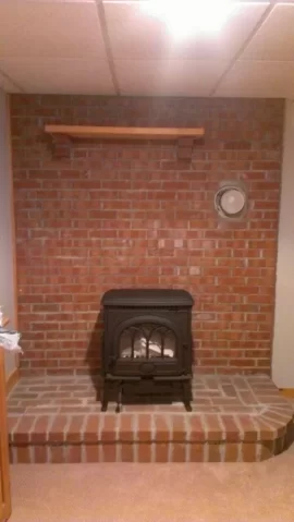

I just took delivery of a Jotul F3 CB and will be using it tomorrow night for the first time! I'm using it to warm up a finished basement and hopefully add a little warmth to the rest of the house on cold winter nights. House is maybe 2000 sq ft. total.
Have heard a bit about making sure to do a small first 'first' before a big burn...Whats the reason for that and whats the best way to do a small 'break in' fire? (how big, how long to burn etc)?
Also, it sits on a brick hearth with non combustible wall behind it. I've seen some post that they put a hearth extension (rug or rigid) in front of the actual masonry hearth...Is that to protect the floor when you open the stove or for heat protection?
Thanks for the help!
Here's a pic (before it was installed)

hey guys, based on the picture what are your thoughts on something in front of the hearth? Will a rug do? I'm not sure exactly why I need it but the installers suggested it...Thoughts?
One reason for starting with small fires is to get an idea how your stove and flue work. You wouldn't want to start with a full load and have the stove get too hot on your first fire. It takes a few fires before you'll know how to load and what air settings work best.
I'd consider a rigid floor protection in front of the bricks to protect the floor from embers that will fall out once in a while.
