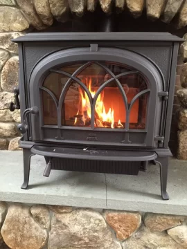

hey guys, based on the picture what are your thoughts on something in front of the hearth? Will a rug do? I'm not sure exactly why I need it but the installers suggested it...Thoughts?
This is more of a code/insurance issue then anything. Your owners manual will give you your door to combustibles masurment. My stove is 16" to combustibles. Also you can factor in the hight of your hearth to reduce that distance.
So see your owners manual and check local code requirements. You may also check in with your insurance agent on their requirements.
I hope this helps answer your question.
