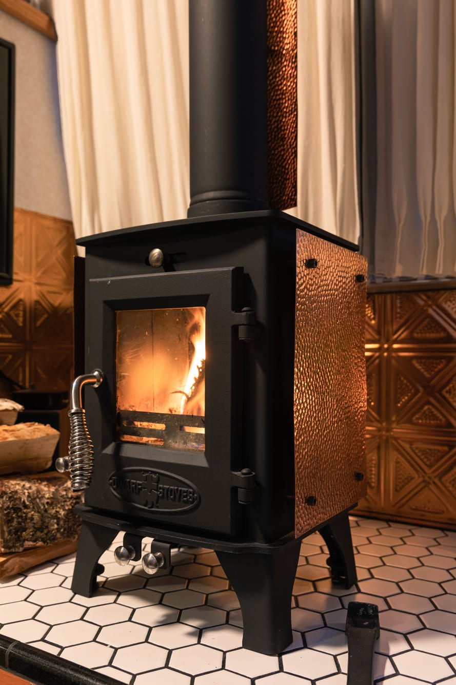

She said her home was 284 sq ft. If that is the case and that number correct...then all the stoves linked to above are far too big.
Try something like this....has outside air connection as well.
