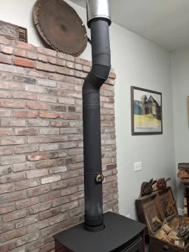

Can someone tell me the Heat Fab part #s and name for the collar that attaches to the stove and the transition pipe to the double wall
pipe at the top. The stove was installed with the pipe with a seam and not the welded pipe which I wrongly assumed all the pro's would use.
Anyway, I'm going to take it apart for the cleaning and I'll re-install with the welded pipe.
[Hearth.com] New Welded Pipe
Heat fab looks like its for gas appliances.
Yes, I was wondering if he meant Metal-Fab stovepipe. If the chimney pipe is Metal-Fab then their adapter is part TGPSWA-6".
Thanks BeGreen. It's Selkirks Safe T Pipe 22 Gauge I was looking for info on the collar
at the bottom It has a band around it like a radiator clamp. I assume U undo the clamp and the slip the pipe up
