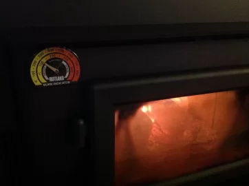

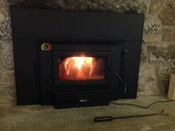

I've been burning some bagged white birch from the initial start up, but I am now learning how to burn eco bricks. From what I have heard they burn hot and long, but again the installers said no more than one in there at a time. Contradicts what some eco burners here say. I have found they are difficult to get burning and they come now where near as hot as the birch did with an even smaller fire. I felt brave and put TWO in there and it barely reached the burn zone. See the image below for the thermo with a bed of coals and two eco logs, air on mid point. I really don't have any split wood yet, although I have quite a few trees which I have ear marked for death.

Looks great Phoenix! Be careful with the ECOlogs as they can burn hot and many stove companies warn against them and may void your warranty. You need to focus on next year and beyond with your wood supply ASAP. Any wood you cut, split and stack in the wind now might be ready for next burning season unless it is oak which needs 2+ years to dry out. Ash, cherry and maple (there are other woods that dry in a year as well) would be good for next winter if you get now but you need to stack it off the ground and top covered only.

In the pic, your ecologs/bricks are too far apart, you're giving them too much air space. With two you're probably ok, but if you add too many like that you're going to be seeing what nuclear means in a stove. I give them maybe 1/4" between them, usually right next to each other with space on the sides, front and back for expansion (they "grow" a bit as the burn). The idea is to get them together so they basically become one big brick as they burn, maxing your burn time and lessinging the "run away" possiblities.

The Eco Bricks still don't come near the birch in heat. Of course not loading the stove either and am just stickin my toes in the water 1 at a time
