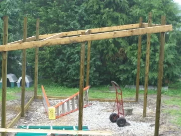

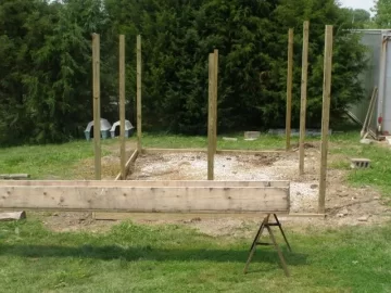

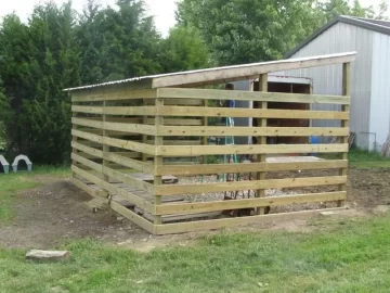

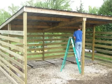

Just got my new wood shed built its 12' x 18' when I fill it, it will hold 10 cords its about 20 feet from the back door!

Nice shed, how deep are those 4x4's and did you use concrete to set them?
They are 34" deep and I did set them in concrete
Shed looks great and plenty of room.. The roof supports seem spaced a bit far do you think snow/wind loading could cause a problem?
Ray
42in. and you could have drop the concrete....But never can really over build! :cheese:

Great looking wood shed, what did you use for making your holes?
Ray
They are spaced 3' apart and should be fine plus added two 2x6 supports in the center just in case of snow weight
zapny said:
Zap
I used the to-30 tractor with post hole auger. The holes are minium of 34" deep with concrete
Great looking wood shed.
Good air circulation, pallet floor, metal roof. You're styl'n.
