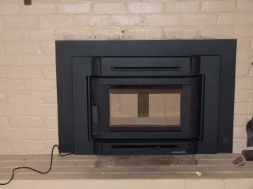

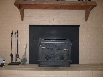

I bought my house a little over a year ago (built in the 70's) and it had a timberline wood stove. The stove did not have a blower on it and was, so I thought, very inefficient as I could only heat the basement to about 70-72 degrees. I could only get those temps when the stove was piping hot and with a fan pointed at the wood stove to help reverberate the air to another fan blowing it out into the room.
I looked a long time at stoves and wanted something a little more modern but still could produce heat so I bought the enerzone destination 2.3i. It looks great but the stove does a very poor job heating. The stove itself is hot and blowing hot air but it does not seem to heat the basement but I cannot get a temp higer than 70 and that is even with a heat pump running at 70-72. I am stumped.
I broke the stove in slowly so I am just wondering if anyone has ever come across this or has ideas. I grew up with a wood stove as a kid and it used to heat our whole house.
The basement is finished if that makes a difference. Also, the basement is about 1,200 square feet and the main room is probably 500 square feet where the stove is. The stove was professionally installed and my chimney does have a liner.
It seems like the stove heats the masonry brick but not the house.
Nothing like pissing away $3K - 3.5K.

Is there a block off plate installed at the top of the fireplace opening? If not, you are probably losing a lot of heat up the chimney.
The basement is well insulated? What about the floor? Concrete sucks up a lot of heat.

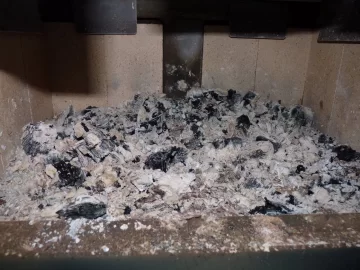

Is your wood dry? By that, I mean split and stacked in the open for at least a year, two years or more for oak. Can you shut the primary air down and let the secondary combustion do it's thing? Running with the primary air wide open sends a lot of heat up the flue. Dry wood is key for operating a modern stove properly.

There is a block off plate that is installed. The flooring in that room is berber carpet with a carpet pad installed. The wood is dry and seasoned.
I just had my chimney guy come back out and he thinks the stove is just poorly designed with an underpowered blower. The blower does not force air out like I would expect. The blower make a lot of noise but you cannot feel the air more than 2 feet from the stove. The chimney guy (Not the person who sold it to me) thinks the stove is just a POS. I am scouring the web to see if anyone else has this stove and what their thoughts are. I contacted the seller of the stove and they are calling the manufacturer.

The old smoke dragon and new efficient Enerzone both got room to only 70*. I think you're losing heat to surroundings. Is the masonry FP below grade? Heat may be going into planet Earth.
the fire place is below grade but not by much. Maybe two - three feet. The heat is definitely going straight out. The blower is not capturing the heat the redirecting into the room. It should not be this complicated and I would think that being an insert that the design would be such that the heat would be transferred out as much as possible and not up.
There is a blocking plate and a line that goes all the way up through the chimney. I know I am losing all the heat straight out because the brick last night was so hot downstairs that it made me uncomfortable that the brick was that warm and thought that it could be dangerous since it was extremely hot.

Now, I cannot stress the importance of dry wood for this stove. As in 15% -20% moisture. As in drier than anything I have ever run through a smoke dragon. I cut, split, and stack our wood 2 years in advance now, with 3 years for oak. Go to the grocery store or someplace that sells bundles of kiln dried campfire wood. Get 3 or 4 bundles of that and fire the stove with them. If you can heat your area with that, then the problem is your wood.
If that isn't the issue, then look at how you are firing the stove. Use an IR gun to get some numbers. Is the stove hot enough to get the secondaries to light off? Is the wood dry enough to get secondary light off? On our stove, we can't get the secondaries burning if the wood isn't dry enough. I typically run ours with a 600 degree stovetop temp, and the area just above the door is usually 4-500 degrees. About midway through the burn, are you getting much smoke from the stack?

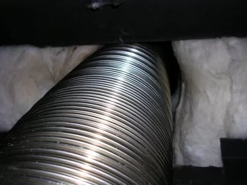

Just to confirm - there is a block off plate at the damper level that is backed and sealed with roxul or kaowool insulation. Not trying to badger you, it's just that some installers call the top plate a block off plate.
If definitely yes, then the room is sucking out heat faster than it can be produced. The Enerzone is not a pos, it's just struggling to keep up with the heat loss of this room, probably through the massive brick wall behind it. It may not have been the best choice for this space though. It is largely a flush stove and it will need the blower all the time running.

Yea that old stove sticking out into the room was putting more heat into the room then a flush mount.

I have attached a picture of the installation the best I could from inside. I have also attached coals from last nights burn (cold) and a link to two videos of the blower. Do not mind the mess we are getting ready to renovate our entire basement.
That is toilet paper I am holding and the air flow looks really weak to me.
Well, if the brick is extremely hot, we know that the heat is getting soaked up by the chimney and bricks and not radiated out into the room.
