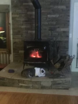

Ashford enamel I think they come standard with a dog laying in front of them.
