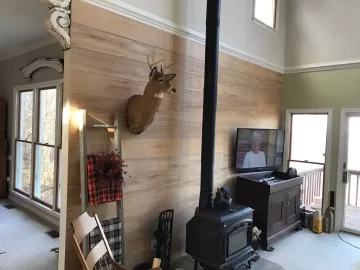

It was the winter before last, the cold long one. That December I put the PH in (avatar) as in October I knew Oslo wasn't going to cut it. So, when all said and done, that Oslo was in that hearth for 5 years and consistently burned 5 cords per year. PH at the end of season, a little over 2. No supplemental heat and the house was warmer.
Impressive, especially if the wood species was the same and there were no other heat loss improvements done to the house.
Thanks for the pic.
I really like my Explorer II I just had put in.

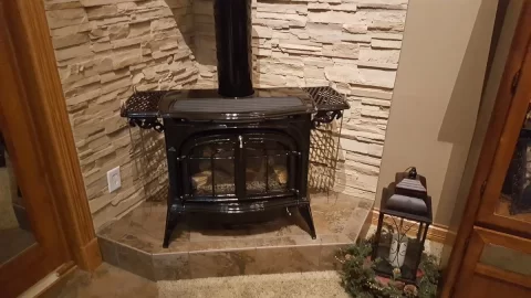

Here is a pic of my VC Radiance vented gas stove. The wife likes the looks of this for a wood stove. It looks almost identical to webby3650's Quadra fire IR I seen him post today. Not sure the Ashford has this look? I think the IR are out of production now?[Hearth.com] New Wood Stove Install Recommendations
Here is a pic of my VC Radiance vented gas stove. The wife likes the looks of this for a wood stove. It looks almost identical to webby3650's Quadra fire IR I seen him post today. Not sure the Ashford has this look? I think the IR are out of production now?View attachment 194686
I hear they did discontinue it. I have no idea why? It was there best looking stove in my opinion.
