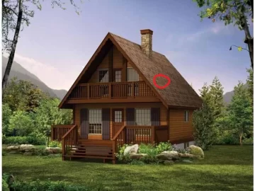

j7art2
Oct 9, 2014
545
Northern, MI
This is a similar concept to my house. Red is where abouts we'd be coming out (on the other side.)
kingquad
Nov 17, 2010
681
Pennsylvania
Could you rent a boom lift and reach it like that? I used one to do some work on a steep roof on a garage I built with a 10/12 roof.
