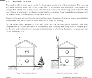

@stoveliker Sure thing, absolutely plan on including a damper, or two, as well as a reclaimer - while also monitoring the stove closely. I live in Minnesota where we can get strong winds for sure, but probably not as consistent as coastal areas.
I’m aligned to your sentiment, however, here’s where my confusion lies:
In reviewing the installation and user manual for the Drolet HT-3000, for example, on page 36 it specifically states that this exterior prefab design we are discussing is “inferior”.
Just like @j7art2, when i contacted my insurance about installing a stove they told me “as long as it’s professionally installed”, and when i spoke with the city inspector he told me 1) they will reference the installation requirements of the manufacturers (stove, chimney, hearth, etc) and 2) the top of the chimney must be at least 10’ horizontal from closest shingle.
I like this Drolet stove, and appreciate their call out of the variables included in the exterior vs interior chimney, but we both know there is nothing unique about this stove (other than not having a thermostat) that would, or would not, require a specific chimney style to run proficiently, and i fear the inspector will point to page 36 and say it’s not kosher.
Are you reading the manual the same way?

On here, common assessment is that an insulated class A is perfectly fine. I don't read the manual as it being not allowed, which would have been a problem.
@bholler knows the ins and outs ;-) of chimneys best.
Regarding a reclaimer, what do you mean by that? I would not put a device in the chimney that pulls heat.out of the chimney to put it in your home. Those do often result in creosote because flue temps decrease.
I highly doubt the inspector will care one whit...he is just looking for "code violations" and couldn't care less about a "performance issue" especially on an install that is so common.
And while Drolet calls out the potential issues with an external install, an internal install can have "high draft" issues easier, so that can be a problem too...guess you just pick your poison and roll with it.
Yes straight up is better from a draft standpoint and cheaper. But if you have 30' of rise you are not going to have low draft issues at all so through the wall will be perfectly fine. And I really doubt the inspector will look at the manual that closely. (If at all)
Also the height requirement is 2' above anything within 10'. Or 3 feet above the point it passes the roof
