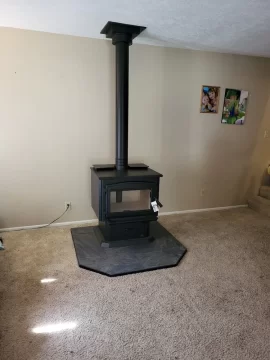

![[Hearth.com] New wood stove install [Hearth.com] New wood stove install](https://www.hearth.com/talk/data/attachments/296/296299-fa07368fb03078e7e931b008d893aebc.jpg?hash=MvrpCsrw8F)
Looks great and the added hearth protection out in front is always welcome.I see why these guys are the top rated in the area according to Google reviews. Extremely professional, extremely clean install, and quite quick. Approximately 2.5 hours for entire install. I chose not to butt the hearth pad to the wall on purpose -- I'd have to relocate a floor vent otherwise.
I couldn't be happier. I can't wait to use it!

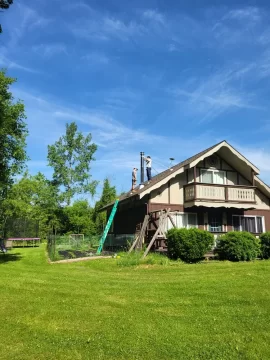

View attachment 296271 View attachment 296272
Minimal...you heat with the stove, not the flue.The downside is that I'm going to lose most of my flue heat inside the house.
Looks good. And congrats on the inspector actually noting something that is a safety issue. You have now a better, safer installation because of the inspection.
Good modern stoves (like yours) are efficient*because* they burn complete and don't push heat up the flue. So you won't loose much with double wall.

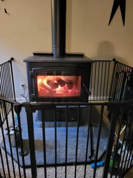

Please post some.pics of the first fires. Note to do that when it's warm enough to open windows because it's going to stink (paint curing).
Follow the manual regarding first fires (so the bricks dry out properly, the paint cures properly etc).
And make sure you have a moisture meter; best to burn below 20pct moisture content but up to 25 pct should work in this stove, if needed, imo.
It may take a few fires to bake the paint in. Try to take the stovetop up to 550 on the third fire.figured the first 45-50F day we get, I'm gonna light a fire, open the window behind the couch and have the box fan sitting on the couch and pointing out the window to pull all the stink out... I hope.![]()
