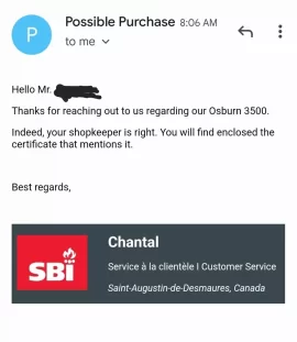

![[Hearth.com] New wood stove install [Hearth.com] New wood stove install](https://www.hearth.com/talk/data/attachments/295/295580-966b6cd32c3bd912054299f296383807.jpg?hash=QPYz2OrPlW)
