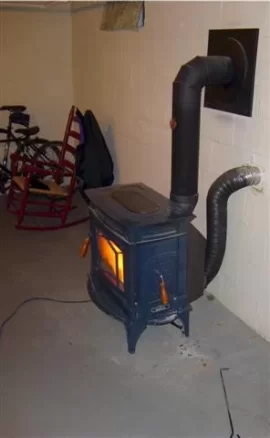

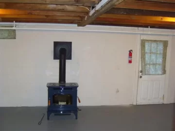

Hi Everyone,
I am very new to using a wood stove; this is my first post. Great website and very helpful! I am having some issues with my stove and I was hoping for some advice and help.
I purchase a new woodstove this past October (Hampton H300) from a local dealer. Every since we purchase it we been having some problems.
1. I have to keep the damper fully opened or the carbon monoxide detector goes off
2. Even with the damper fully open (burns great during the day and evening ) but through the night when I wake up it has a reading on the CO (it does not go off, just a reading of 48ppm)
(This does not happen everyday, but every other day)
When I wake up around 6:30a.m. The carbon monoxide detector reads 48 ppm on the digital read out. I open all the doors and windows for 5 minutes and it read 0 ppm. I open the stove and a couple hot coals are in but manly grey ash. I empty the stove out complete and take the ashes and hot coals out side. I am afraid to run during the day during the workweek. (We have pets and I do not want anything to happen to them) Then when I get home from work about 5:30p.m. I fire the stove back up. (During the weekend I run both Saturday and Sunday all day and no problems during the day)
I installed a fresh air kit as recommended by the dealer. It really does not seam to be any different. I had the dealer come over and check everything out and said everything seems fine

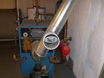

The damper on the oil furnace seems to be open a lot. Could this be causing the problem?

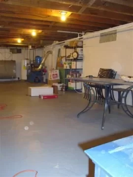

It may be negative pressure in the basement. Have you had the boiler checked to see if it too needs a fresh air supply?

Maybe someone with more knowledge of oil furnace will be along shortly, but I can’t see why that damper would be open at all. This is the flue for the oil furnace, right? (I really don’t even know why it would be there to begin with). Additionally, if both appliances are in the same room / area of the house, you may have some pressure balance issues. You mentioned a fresh air kit (for the stove?) so that should help a lot. Also, anything in the basement which exhausts air may be making the problem worse...vent fans, clothes dryer, etc - can all pull air from the basement and blow it outside...and cause the flue to reverse flow. But my main thought would be close (and seal) that damper on the oil boiler...I can't imagine that it would do anything besides leak combustion gas back into the basement. Wait and see what the oil guru’s say.
You do need that damper for the oil burner, it keeps a constant -.03" to -.04" draft if set correctly and the chimney is not obstructed. If you seal that up, there goes you oil burner effeciency. Air or fumes should "NEVER" come out of that damper, there should always be a negetive draft pulling air from the room up the chimney. Now, I am going to directly contradict my NEVER statement...sometimes on ignition, there is a slightly positive pressure which should cause the damper to close briefly, or in my case slam shut because the Utica and Becket AFG factory combo does not play nice with each other in some circumstances.
So yes, a qualified Oil Burner Tech should have a barometric draft meter with him to test you flue draft. Make sure he tests the draft BEFORE any work is performed to get sort of a benchmark, also don't adjust the damper yet. Clean the burner, brush the boiler down and vac it out, clean and inspect the flue pipe. Put it all back together and test again. Now after firing up a clean boiler with a clean flue you see a more accurate draft reading and adjustments can be done if needed.
If the proper draft adjustments are made and you still see CO readings, check for other devices causing a negitive pressure in the basement, like a dryer. Then again, if you have a dryer down there, after the tech cleans and adjusts the boiler, try turning the dryer on while he has the draft meter in the flue? See if that does make a difference.
That damper is really open alot. The nerd in me would try to determine if air is flowing into or out of that barometric damper. As easy as holding a match in front of it.
Such a pretty stove to bury in the basement.

Don't even think about blocking or jamming the barometric damper on the oil boiler. Screw up the works if you do that.

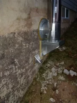

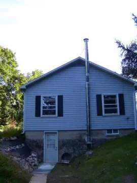

Hi Everyone,
After a long battle trying to figure out, it was a simple fix. The problem was the Chrome Dura-Vent Chimney pipe on the outside of the house. The clean out on the bottom of the pipe, was missing the cap that screws on. I bought a cap and installed it. Everything has been great! Wood stove burns great and no C.O.
I did have the oil furnace cleaned and the tech said the damper is adjusted properly.
Thanks for all your help!
Dave
Glad you solved your problem and with an easy fix. (Wish the WI girl could do that with her CO problem). With that cap off, wasn't the stove burning poorly because of lack of draft? Wonder how the CO was back feeding into basement?
it was a lack of draft. with the clean out cap off, i would have to keep the damper fully open and CO would go off or have a reading every morning. Once, i put the cap on i am able to close the damper practally all the way. It is be able to burn for a long time and no problems with the CO. It has been about a month and no problems
