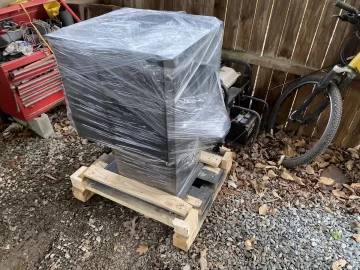

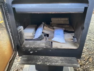

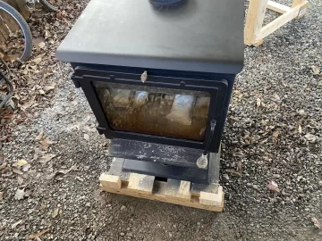

I’ve got one sitting in my carport right now. It’s the England’s 50-SHSSW01.
