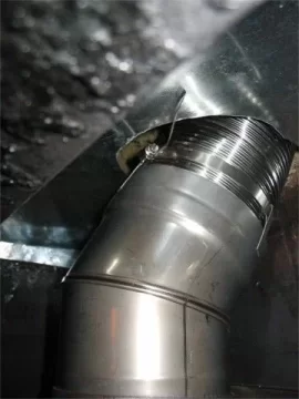

An easier way is to use a 30 degree fixed angle stainless steel elbow.
i dont know if i would have room to fit it in there , top of stove is 21 inches from hearth, angle iron is 26-1/2 inches. if i pushed the whole unit in 3 inches it would fix the problem, but surround would have to be custom fit to fit inside of fireplace hole.

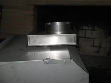

Thanks for reply, i spoke with insert dealer and he said simpson makes an offset flue adapapter that is low profile and will take it back about for inches, going to look at it tommorrow. anybody seen or used such product? searched online coulndnt find it.
I have one like that on my I2400 Regency insert. I was concerned about it restricting my draft but it works great. Makes cleaning the liner a little more difficult, but not bad. You have to scrape or vacuum the creosote that falls down from top down cleaning since it doesn't all fall into the firebox.
