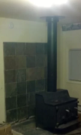

Thanks Begreen...I posted a couple weeks back...here are the suggested pictures and details.
I bought a Fisher Grandpa Bear.. built a "non combustible" wall, I think...wall is 5' wide x 6 ' high...one inch air space (maybe 3/4" by the time I got done drilling) Cement backer board with slate attached...nothing is looking too pretty yet. I am considering putting 1 X 6 pine on the walls surrounding my slate.
The "non combustible" wall has 3/4 cement backer board with slate attached. It hasn't fallen down yet. Whew.
There is between 3/4 and 1" airspace behind. It is raised up at least 2" off the floor to let air flow behind.
Stove is 35.5" to combustible wall, which is mostly windows.
Hearth pad is 6' x 5' with stove in the middle, 26" from stove feet (threshold) to end of hearth pad. 3/4 cement board under the same slate.
I plan to finish the rest of the room in 1 x 6 pine, tongue and groove, wall and floor. I wonder if the non combustible wall I built is not enough?
I have been trying to learn the Fisher stove and heat output....
thoughts?

One suggestion: If you want to trim out the air space with ANYTHING on the border of that wall protection, you need to leave gaps specified by the NFPA211 for the air to circulate between the protection and the combustibles behind it.
Yes, pine trim needs to be at least 36" away from the stove. It could be trimmed on the side with aluminum or steel angle iron painted black for a picture frame look. The top needs to stay open for ventilation, but the same metal in flat stock could be screwed to continue the look across the top if desired.
You built a heat shield, not non-combustible wall. If you used 1 inch spacers, it can't get closer to the wall that that unless the wall is uneven......... The shield won't fall away from wall if screws penetrate at least 1 inch into wall studs behind it.
Don't know what you mean by if the heat shield is enough; larger air spaces at the bottom would be better, like setting on half bricks. It's all about air flow.
https://www.hearth.com/econtent/index.php/articles/stove_wall_clear
[Hearth.com] Newbie - Fisher This diagram shows the size required.
If it doesn't have a baffle inside the stove, that is the single easiest thing that makes the most difference you can do. Later stoves had them. You can slow the draft with pipe damper, but that doesn't do what a baffle inside does. The baffle thread in Fisher Forum gives details and pictures.
