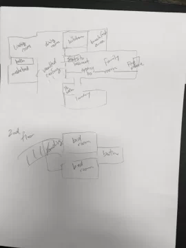

Please please excuse my artwork! This is a rough sketch of the first and second floors. So the 2nd floor area would be on top of the family room/breakfast are...for the most part.
It's about 30' from the fireplace to then what opens up to the vaulted ceiling and the second floor landing area.
Hope this helps a little? Any thoughts.

That's helps a lot. The floorplan suggests that the stove is primarily going to heat the family room and kitchen area. The upstairs bedrooms will get some warming from the stove due to the heated space below. Do the stairs going to the 2nd floor start in the vaulted room area? Are there doors that close off the vaulted area from the kitchen/family room area?
One thing that would help distribute heat would be to run an insulated duct in the basement from the living room to near the fireplace. Heat distribution would be helped with an inline fan in the duct, pulling air from the living room and blowing it into the far end of the family room. There are some quiet inline fans that could be put on a thermostat in the family room so that when the room got above say 75º the fan comes on.
The stair going to the second floor do begin in the entry way with the vaulted ceiling. There is a door between the kitchen and the "dining room"/vaulted ceiling room. There is a doorway (but no door) between the kitchen and the breakfast room. There is no door and no doorway from the family room to the entryway room...it's a very open transition.
I'll have to ask someone about adding duct work/fans/methods for distribution. That's definitely beyond my skills. Maybe also important to note that the living room area does not have basement under it. The basement is primarily under the entryway, kitchen, breakfast room and family room.
The thermostat is just inside the wall of the living room...basically on the far side of the entryway area.
