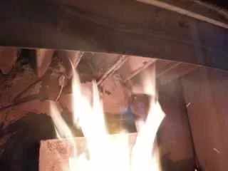

    The wire is about 3/5 of the way back, hanging straight down, between the left and right "plates" of the accordion structure.

    sorry, they wouldn't let me post a bigger photo...

    due to the reflection, I cant make heads nor tails out of your pics, no can I see the wire.............BUT, there isnt supposed to be a wire anywhere in your combustion chamber at all.......there is the probe in your exhaust tube, but you wouldnt see that without removing the cover plate off the cobustion fan. The only other wire in the combustion chamber is to the igniter, but again, it occurs nowhere near the accordian baffle in the top of the combustion chamber.....could it possibly be a stuck on welding rod? maybe a pic with the door open would help, since we wont have the reflection in the room?

    hopefully you can see it now? right in the middle of the pic, pointing down and toward the front?

    It's about 2" long, and sticks out from the approximately 3mm gap between the two "plates" of the accordion. Could be some kind of welding - I don't know. I just bought the stove this year, is it possible your model is different?

    cant see it well, but, having sold several hundred harmans this year, I can tell you unequivicably that it ISNT supposed to be there! No Harman models have this. Although I can t tell, I concure its PROBABLY a welding rod. I'd call the dealer on this............

    x2 on calling the dealer, that's not supposed to be there.

    you should ask him what that wire is for, hanging from the heat exchanger of your brand-new, still-under-warrantee Harman p43.....Im guessing his answer will be........"wire?.....what wire?......INSIDE the stove?.......from the heat exchanger?!.....aw, you must be mistaken....there's no wire in there........." or some reasonable facsimile thereof.
