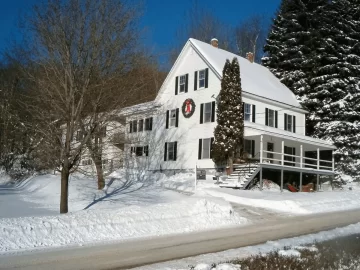

Here is a pic of the house from a few years ago taken from the street . The stove would be in the original portion of the house where the chimneys are .....
[Hearth.com] Newbie in need of help .......
It's actually an up/down duplex & I have a small business in the garage area ...........
How close are the trees on the far side? Would they screen the visual of the exhaust while still being a safe distance away?
It looks like you could come right out the driveway side of the house , straight out the top of the foundation or even sill plate, with a termination spout. You should already have enough vertical rise in the basement for some positive draft. Pellet stoves are pretty direct vent unless you just want to clear the peak..

Lake Girl ... The trees are about 6ft away from the house &would help to hide a vertical pipe .
Alternative heat... My concern on the driveway side is that I will end up needing some amount
of vertical rise & that exhaust would discolor the white siding over time . If I went the route of lining the chimney & running the exhaust there could I make a horizontal run of about 15ft in the floor joists to the outside for the OAK?
