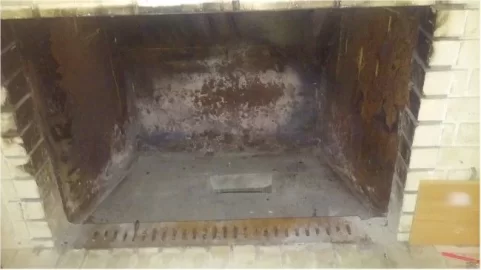

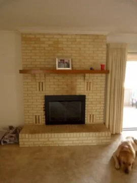

Have you already established that the current fireplace can be fitted with an insert? Not all pre-fabs can.
Yes, I have measure the firebox pretty accurately.
The Summit will just fit.
The existing fireplace has an ash cleanout 4x9" that I will use for combustion supply.
Also has a vent along the hearthstone right at the front of the fireplace that I am wondering if I need to plug
given the cleanout.

NM... didn't see you had masonry around yours. I still would be carefull cutting anything out.
I'm not sure what the OPs set up is regarding prefab or not.
I know with mine it's a masonry cement block chimney that was built with a metal firebox. It was built with hollow cavities above the firebox with vents so hot air could escape. It actually heated very well as an open fireplace but like all open fireplaces it was not efficient. I would burn through 3 or 4 hardwood splits in 30 minutes.
In my case cutting the metal firebox had no negative effects ( other than never being able to return the fireplace to an open fireplace).
Assuming the OP is ok with cutting the metal firebox, I guess if I were the OP I'd probably choose an insert that requires the least amount of cutting.
Also in regards to the laminate floor needing to be extended 2 inches. In my opinion it's worth it to get the non flush because with the non flush you do get more radiant heat. I find the blower annoying at times and happy that I really don't need it usually. If I had to run the blower constantly I might get frustrated.
Unless you just want the look of the flush stove my suggestion is the non flush for a little better radiant heat. Just my opinion

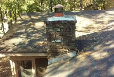

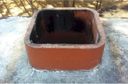

There is another matter and maybe I should start a different thread to discuss it.
Installing a new flue insert is only going to give me a total of 12' of flue length from the stove to the cap on top of the existing chimney.
This is 3' short of the manufacturer's spec of 15' for these stoves.
So what I am proposing to do is add three more feet of clay liner 12"x12" by building a mini chimney on top of the existing.
Of course I will have to anchor the new section to the old.
Any warnings or suggestions?
Good weather still in Arkansas to do masonry :)

Yes, a 15' flue is what the stove was tested with. FWIW, a buddy has his Summit connected to a 12' chimney with a 90 and two 45's in the connector. It drafts pretty well, especially when the temp drops below 50F. I'm wondering if you will be able to slip an insulated liner down there? What is the tile liner ID?

the OD of the insulated SS Flex liner (w/ .5" insul) will be 7.75" OD
The Terracotta flue tiles are actually 13 x 13" so there should be plenty of room inside, and I will cut a 10" dia. hole in the firebox for easy passing of the liner through the firebox to the stove.
