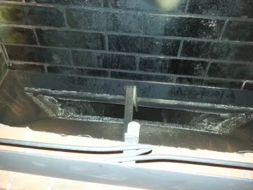

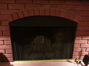

Hi, I am a newbie looking to get a lopi freedom insert with 6" Stainless steel flexible liner installed. I don't mind doing the dirty work. I have read lots of post that some use torches, hacksaws, sawzall, chisels, pliers, safety glass and respiratory to remove/modify their dampers. How long did it take the dyi-ers to do the own installs?
My 411 in my fireplace damper area: it has a taper to it (see pic) and my chimney has an oval clay liner.
The oval liner is large enough to take a 6" liner with insulation wrapped around it.
I believe my smoke shelf is offset from clay liner not afraid to take down some bricks to make room for liner.
Any tips/comments?

At my BIL's, I didn't have a torch but the Sawzall made pretty short work of it.
Reactions: jaychino415
Yep... I'd keep the torch away from the masonry. Remove damper, then recip saw (saws-all) or angle grinder is the way to go for cutting the frame, as needed.
Smallest dimension on your oval clay would need to be 8" or more, for a blanket-wrapped 6" liner. Offsets make pulling tough, but unless they leave a cross-section below 8", you should be fine.
I started with an angle grinder but man it was dusty! Decided to go to the Milwaukee Sawzall. >>
I used a 4.5" angle grinder on mine, was quite easy. Took me less than an hour I'd say. Lots of sparks, but not really that much mess. I don't have carpet, so I wasn't worried about cleaning up soot and ash. A shop vac took care of it quick and easy. I did have to remove a couple of bricks behind the damper, but that was much quicker than cutting through the damper itself. Very messy when the angle grinder starts going into masonry, though. I popped them out with a hammer and chisel.

Thanks Tom for the tips and advice. I just trying to figure out what I was getting myself into.
Should I get a certain type of sawzall blade to cut the damper with? Thanks, I will definitely measure everything 3 times before I do anything.
Any ferrous metal cutting blade will work. Grab a few, it may take more than one, before you're done.
