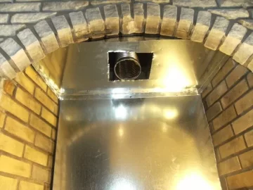

Sheetmetal damper block off plate. This one is 22guage Galv that was eventually painted with black high heat paint. Regardless of the blank deer in the headlights stare you will receive from most professional installers when asked about it, This novice swears its a no brainer especially when the chimney in question is external as mine is.. It took some time and effort to fabricate but the payoff is huge..
