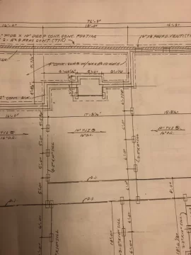

I hope this gives a better idea on what I want to do...the drawings show brick, but the chase will more than likely be a natural stone (small flagstone) chase. Instead of a bump out into the room, I want to frame an “out” where the chase is shown...in other words, an alcove. This way I can come up from the stove hopefully straight, but maybe two 30 degree offsets if I’m unable to get the stove deep enough in the alcove to do a straight pipe to the ceiling support. This way there will be no pass through in an attic, roof, etc...just great room ceiling, straight into the chase.
