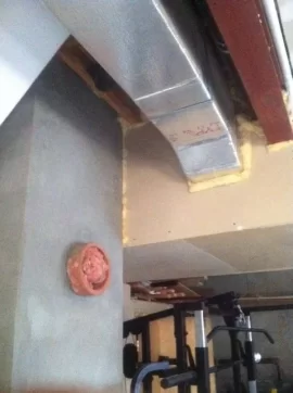

Basement (pic):
Here you see where the guy that built it left space for a furnace in the basement. Above you can see the duct coming from the handler and that goes to zone 1 & zone 2 with the oil heating. To the far right you can see where the oil boiler room is. The other part of the basement is finished with vents but not sure if they even work. Here i'm trying to establish if it's possible to route the heat (somehow) from a wood furnace below maybe into the handler / duct and just use the fan switch perhaps? I'm lame when it comes to these things but hopefully the picture will make it more understandable? not sure if that's a good idea as I assume if I put one down there it would be of no use for floor 2 without routing it in a duct?

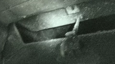

The basement chimney runs the side of the basement stairs (next to the toilet there to the left of A. It runs behind the FP too into family room. In the fireplace has one of those dust shoots which goes down to the bottom of the basement so it's kind of multi-faced. The breast runs to the right of the stairs and the left of the FP.
Dang, with the basement too. So with the stoves, there's nothing I can really use to funnel into the ducts / handler, or is it all like you say - just to heat a space? :(

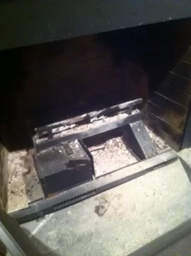

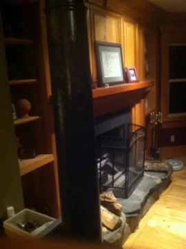

Hi Andy, welcome to the forums !
A better pic of the interior of the FP, and maybe an upwards shot of the flue would help.

Tx! Hopefully the two I've posts gives a better idea. Upstairs is same layout but to be honest i'm not THAT bothered about the upstairs, it's really just the living room as I work from home quite a bit. Yes stairs are spiral.
B is basically where my sofas/ tv etc is and to the left is my front deck. The chimney is literally where the basement stairs are and to the back of the fireplace. I don't really see place to install a fireplace on B, A maybe but would kind of be the first thing you see when walking in the front door. I was hoping to make use of the fireplace(FP) / not doing any drastic modifications to the walls etc :)
