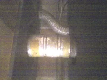

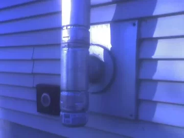

I have an Englander Pellet Stove that came with the house when we moved in 2 years ago. The installation was done 2 years prior (I think). We used it last season with no smoke smell, no problems. This season the first few burns were ok but now we're noticing a smoke/combustion smell when firing up the stove. I have to open a window to get fresh air in room to clear it. After stove gets up to temp the smell goes away.
I think it may be an improper seal around the vent pipe. The pipe from the stove conects to a larger pipe to the outside so I'm thinkging to get some high temp sealant to put on that. Looks like the installer put some on. Does sealant break down? Is this normal to have to 'reseal' the pipe?
Another question on the cleanout. The vent pipe has a cleanout outside. Mmm silly question maybe but I'll take that risk. How do I remove the cleanout cap? Does it screw off or do I have to use a screwdriver and pry it off? I should probably get a brush/tool to clean it since I don't know it ever has been. How often should it be cleaned out? If it gets ash buildup would that contribute to smoke inside because of poorer exhaust flow? Oh I think I just answered my second question, duh.

Sounds like you need a total cleaning of that stove the fire pot and vents. If not done in a whilem its long over due. Go to englander web site and dowm load
the manual it will tell you the mantainance routine and frequency. After 4 years the door gasket also could be suspect or the door latch needs adjusting.
as for re sealing the pipe joints a good idea but you have to scrape out all the old caulk first silicone can not be applied over old silicone and adhere

-The exhaust pipe. Get a pellet brush and sweep the chimney. Including the section that goes through the wall into the combustion blower.
Rarely does the pipe need to be resealed, unless taken apart. I would do the cleaning first then consider resealing if the problem persist.
Twist it counter clockwise about 1/4(?) turn and pull it off. They can be on pretty tight. An band wrench (or whatever they are called) helps alot. (I mean the same type of tool that you would use to remove a oil filter on the car.) Be aware that a few cups of ash might come pouring out.
Thanks Elk and Josh,
I got a pellet brush at the fireplace store and cleaned the stack outside. I always give the stove it a monthly (or so) cleaning, heat exchanger, burn pot. etc.. I have to get a gasket to replace when I pull out the combustion blower to clean that and the length of horizontal exhaust pipe that's inside. I ordered online from England's Stove Works. But the stack cleaning seemed to do the trick, I got a couple cups of ash out of it. No noticeable smoke smell and it sems to burn hotter/more airflow. So I'll leave it for now and pull the blower for a full cleaning at the end of the season if its working ok.
