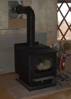

Thanks for your thoughts on my coaling problem. I headed home to the flatlands to avoid this winter storm so I can't provide you with exact measurements of the cabin chimney. Below is an interior picture, you can see there is a 3' vertical run followed by at most a 4' horizontal run that goes straight through the wall and immediately connects to the 90 degree elbow for the vertical run. You can see the transition to the metlabestos class A stainless steel pipe in the picture, the rest of the run is all the same pipe. I believe the outside vertical run is about 12' (for 15' total), it could possibly be just 10', giving me just 13' of vertical run, worst case. My elevation is 4,000 feet, could this really be the source of my problem?
Tx, Anthony

If you notice the stove performs sluggishly when temps are warmer and some smoke always spills out the door, it may be weak draft. There are 2 90 deg. turns in the smoke path that are reducing the effective length of the pipe. I think if you can add 3 feet the stove will draw better. By the way, while adding things, the hearth needs to be extended so that there is 18" protection in front of the stove. At some point or other, embers or perhaps a chunk of a hot log will fall out onto the hearth.

Be Green, thanks for the tip on increasing the hearth, also I didn't know the 90's decrease the effective length. So far, I've never had any draft issues nor any smoke come out the door, I'll keep an eye out for any change in behavior when the weather gets warmer. Adding more 3' more flue length will be difficult but I'll look into it, I've got very high wind loads so I can't just pop on another section. If anybody else has ideas/suggestions on my coaling issues (plain old operator error??), I'd love to hear them.
