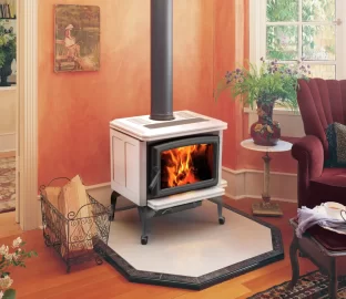

This is the smaller Vista in that trim.

The PE Super Classic and Vista look awesome. I still feel like ascetically the Shelburne has the lead, but I want to end up with a great stove in the event we move to burning more aggressively through winter. Jotol F45 comes to mind for that purpose from the kind reocmendation of begreen above, and what I have read and come to understand...
