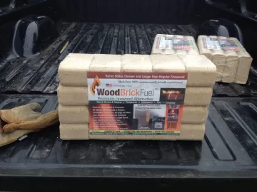

[Hearth.com] Newbie...trying to get seasoned firewood in late September I really enjoyed these, there made in PA and the info is on the package.

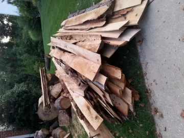

I just picked these slabs of wood for $25. Probably cost more in gas driving back home. 3000 lbs of oak slabs.
