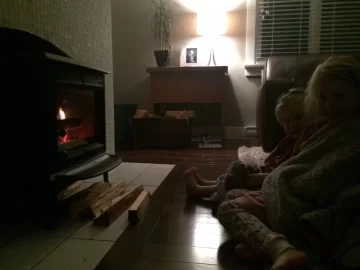

Hello there - I have a Jotul F100 in my living room. I also have a 2 year old and 4 year old. We never used a heat shield/fence and told the kids "oweee HOT" about 5 times and that worked, also if they go close it is very hot so they seemed to have figured that out. We still use discretion and pretty much say that to them every time we fire it up (every day right now). I think its something you always need to be aware of but they seem to catch on pretty quick. They both snuggled up beside the stove last night after a bath it was pretty cute :)

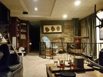

we have a 9month old and a 3 year old. the 3yo understands that fires are hot, but we worry about him "being a fireman and rescuing", so we don't let him play near the stove. Due to the layout of our house, we actually just ordered a large gate and plan on sectioning off a large part of the living room. this allows the little one to play, but we don't have to worry about the stairs or the stove.
It should be showing up today!

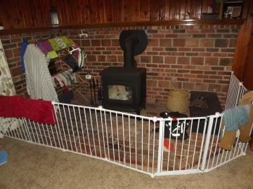

We got ours up yesterday[Hearth.com] Newbie with toddler, cast iron or steel?
